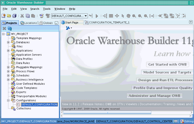

When you install Warehouse Builder and create a new repository, you have a default project with a single automatic default configuration, DEFAULT_CONFIGURATION. See Figure 8-1 and note that each new project has an automatic DEFAULT_CONFIGURATION. You can observe this by expanding the Configurations node in Project Navigator. Note also that the active configuration appears on the toolbar as DEFAULT_CONFIGURATION.
This default configuration contains the default physical properties of all the data objects in the project; these properties are necessary for deployment. As a single entity, the DEFAULT_CONFIGURATION enables deployment to the default control center, DEFAULT_CONTROL_CENTER, and default agent, DEFAULT_AGENT, which are necessary to the internal workings of Warehouse Builder.

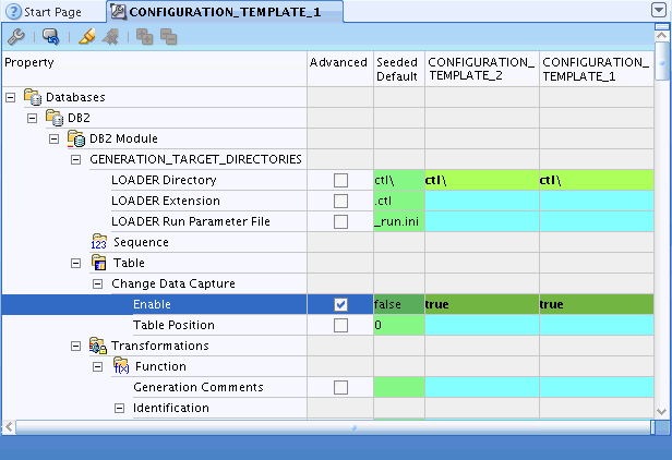

Editing Configuration Templates
To edit the configuration values in a template, use the Configuration Template Editor, which allows you to set the configuration properties of objects to Advanced, and to override the existing configuration defaults.
Note that the configuration template editor can show the different templates side by side, to make it easier to compare and edit multiple templates.
To edit a configuration template:
  1. In the Globals Navigator, under Configuration Templates, click the Manage Configuration Template Columns icon.
    Description of edit_config_temp_01.gif follows
  2. In the Select Templates window, select the templates you want to edit.
    Click OK.
    Description of edit_config_temp_02.gif follows
  3. Click the Expand All icon.
    Description of edit_config_temp_03.gif follows
  4. Make changes to the side-by-side templates.
    Description of edit_config_temp_04.gif follows

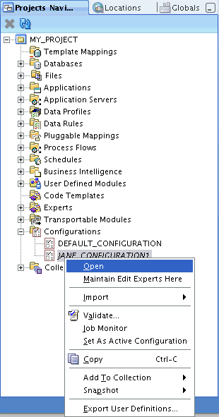

Activating Configurations
To activate a configuration:
  1. In the Project Navigator, select a project and expand its navigation tree.
  2. Expand the Configurations folder.
  3. Select a configuration.
  4. Right-click the selected configuration; from the menu, select Set As Active Configuration.
    Surrounding text describes set_config_01.gif.
All changes that you make to the configuration parameters of objects are saved in this configuration. If you switch to the previous configuration, these parameters show the settings of that configuration.
The Control Center service and Control Center Agent associated with this configuration are now set; they manage all future deployments or executions.
