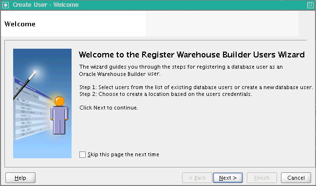

    The Create User: Welcome screen appears.
  2. On the Create User Welcome screen, click Next.

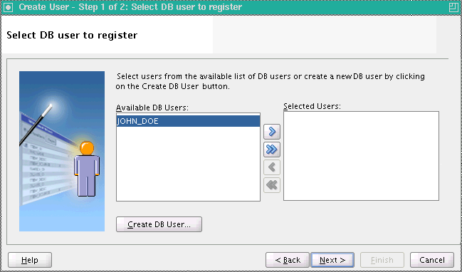

  3. On the Select DB user to register screen, under Available DB Users, select the user or users you want to register, and click the appropriate transfer icon to add the user or users to the Selected Users list.
    Click Next.

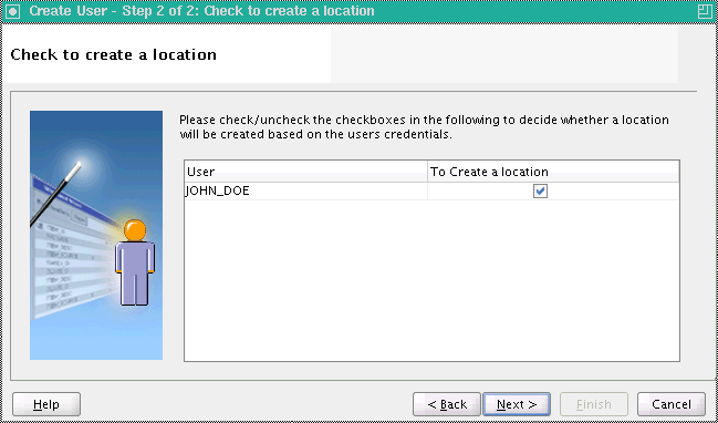

  4. On the Check to create a location screen, check Create option next to the user you are registering.
    Click Next.

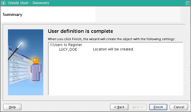

  5. On the Summary screen, review the new user definition.
    Click Finish.

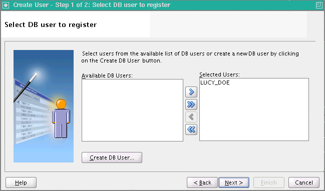

  3. On the Select DB user to register screen, click Create DB User.
    Description of new_user_08.gif follows
  4. On the Create Database User screen, enter the DBA password, and the Name and Password (with confirmation) of the new user.
    Click OK.

  5. Note that on the Select DB user to register screen, the new user is automatically added to the Selected Users list.
    Click Next.

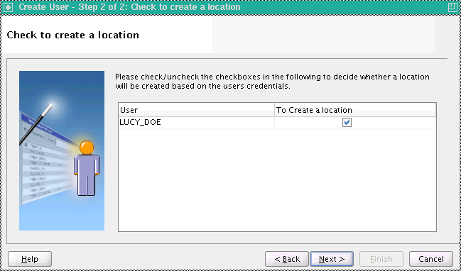

  6. On the Check to create a location screen, check Create option next to the user you are registering.
    Click Next.

  7. On the Summary screen, review the new user definition.
    Click Finish.

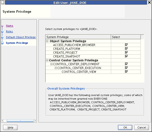

    • System Privilege: you may assign system privileges to the user by checking appropriate boxes under Object System Privilege (ACCESS_PUBLIC_VIEW_BROWSER, CREATE_PLATFORM, CREATE_PROJECT, or CREATE_SNAPSHOT) and Control Center System Privilege (CONTROL_CENTER_DEPLOYMENT, CONTROL CENTER_EXECUTION, or CONTROL_CENTER_VIEW).
  5. When the edits are complete, click OK.

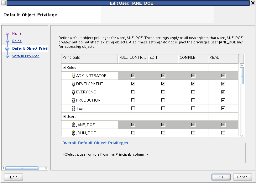

Default object privileges define the access other users and roles have to objects that the selected user creates. These privileges do not impact the privileges the user has for accessing objects created by other users.
For example, for all objects that JANE_DOE creates, JANE_DOE, as well as ADMINISTRATOR and DEVELOPMENT roles, have full access. Note that EVERYONE, PRODUCTION, and TEST roles are restricted to read-only.
Description of object_priv_01.gif follows
If you are familiar with UNIX operating system security, note that the default object privilege is similar to the UMASK command. When you edit the default object privilege, the change only effects objects the user creates subsequently; there is no effect on previously created objects. Therefore, if you set default object privileges early, you can expect little or no additional object-level security management.
To define the privileges other users have to objects the selected user creates, check the appropriate box for each role or user. You can grant the following privileges: FULL CONTROL, EDIT, COMPILE, and READ. All the privileges are additive. If you select COMPILE, then you apply both the compile and read privileges.
Note that access may be granted both to roles and to individual users. Note, however, that when you grant access to a role, the privilege is extended to all users in that role. For example, even though JOHN_DOE is not specifically granted access, he has read access through the EVERYONE role. Furthermore, if JOHN_DOE is a member of the DEVELOPMENT role, he has full control and access.
By default, when you create a new user, the EVERYONE role has full control on all objects. To enable metadata security, edit all user profiles and restrict the access the EVERYONE role has to objects each user creates.

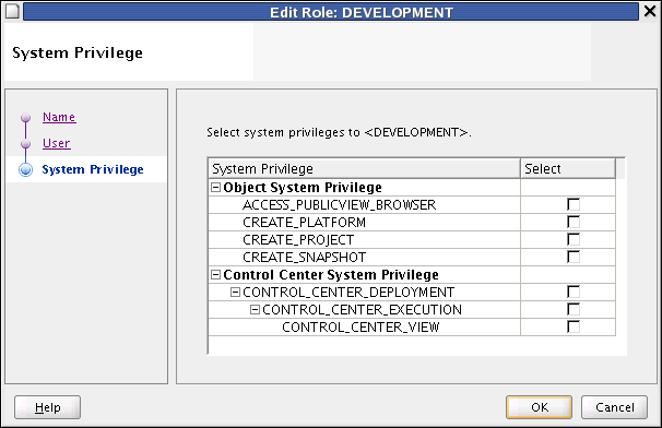

System Privileges
System privileges define user access to workspace-wide services. Use the System Privilege tab to allow or restrict users and roles from performing administrative tasks.
You can control access to the following operations:
Description of system_priv_01.gif follows
  • ACCESS_PUBLICVIEW_BROWSER: Allows users to access the Repository Browser.
  • CREATE_PLATFORM: Allows users to create new platforms in the workspace using OMB*Plus.

To alter default security privileges for a role:
  1. In the Globals navigator, expand Security.
  2. Under Security, expand Roles.
  3. Select the role to edit, and right-click. From the menu, select Open.
    Description of edit_role_01.gif follows
  4. In the Edit Role: RoleName window, you may do any one of the following:

You can grant or restrict access to metadata objects on an object-by-object basis.
To change security properties of a specific metadata object:
  1. Select the metadata object for changing.
  2. From the View menu, select Security.
  3. Edit the security privileges for the object, granting and revoking them either at Role level, or at User level.
    Description of object_priv_03.gif follows
  4. When all changes are made, from the File menu, select Save All.
    Confirm changes.
