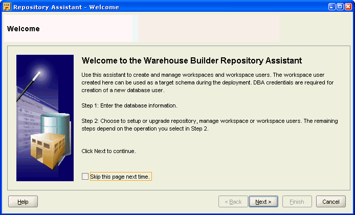

  2. On the Welcome screen of the Repository assistant, click Next.
    Description of workspace_02.gif follows

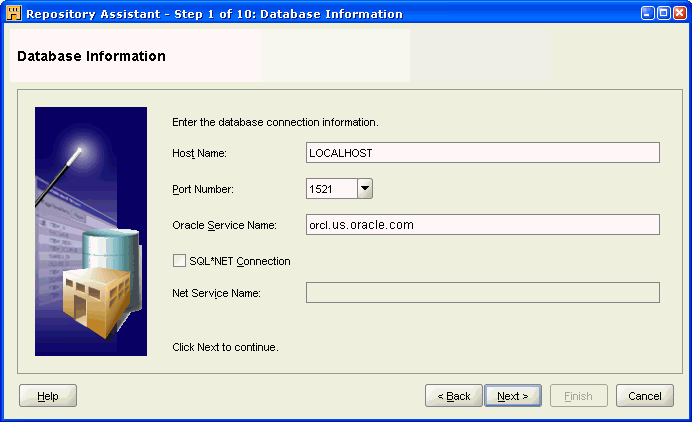

  3. On the Database Information screen, enter the connection information (Host Name, Port Number, and Oracle Service Name) for the repository database, and click Next.
    Description of workspace_03.gif follows

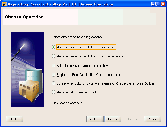

  4. On the Choose Operation screen, select Manage Warehouse Builder Workspaces. Click Next.
    Description of workspace_04.gif follows

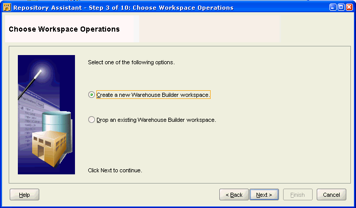

  5. On the Choose Workspace Operations screen, select Create a New Warehouse Builder workspace. Click Next.
    Description of workspace_05.gif follows

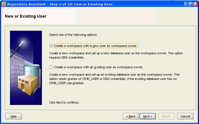

  6. On the New or Existing User screen, select Create a workspace with a new workspace owner. Click Next.
    Description of workspace_06.gif follows

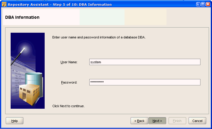

  7. On the DBA Information screen, enter the User Name of a user with a SYS privilege, and that user's Password.
    Click Next.
    Description of workspace_07.gif follows

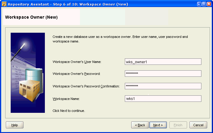

  8. In the Workspace Owner (New) screen, enter the following:
    • Workspace Owner's User Name (wks_owner1)
    • Workspace Owner's Password
    • Workspace Owner's Password Confirmation
    • Workspace Name (wks1) (Note that workspace names cannot contain spaces)
    Click Next.
    Description of workspace_08.gif follows

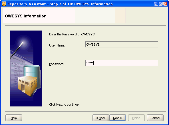

  9. On the OWBSYS Information screen, enter the OWBSYS Password.
    Click Next.
    Description of workspace_09.gif follows

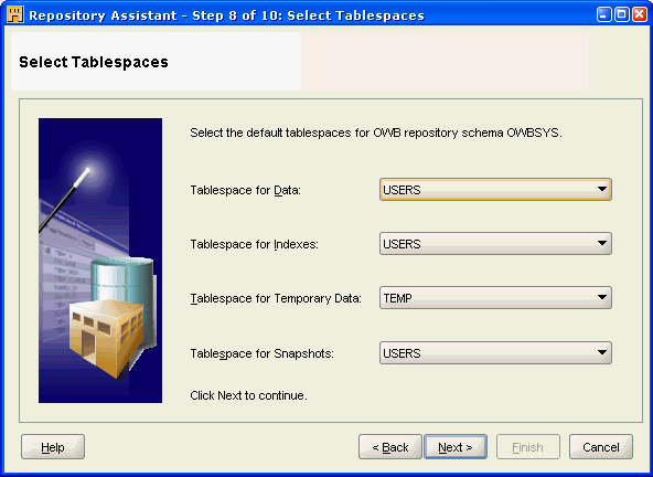

  11. On the Select Tablespaces screen, enter the following:
    • Tablespace for Data (USERS, or the name of the desired tablespace)
    • Tablespace for Indexes (USERS, or the name of the same tablespace)
    • Tablespace for Temporary Data (TEMP)
    • Tablespace for Snapshots (USERS, or the name of the same tablespace)
    Click Next.
    Note that this step enables you to change the default tablespace details. The OWB repository is stored in the OWBSYS schema, but you must identify what tablespaces are used to store OWBSYS and certain other objects, like snapshots. You may choose tablespaces other than USERS, depending on your storage management strategy.
    Description of workspace_10.gif follows

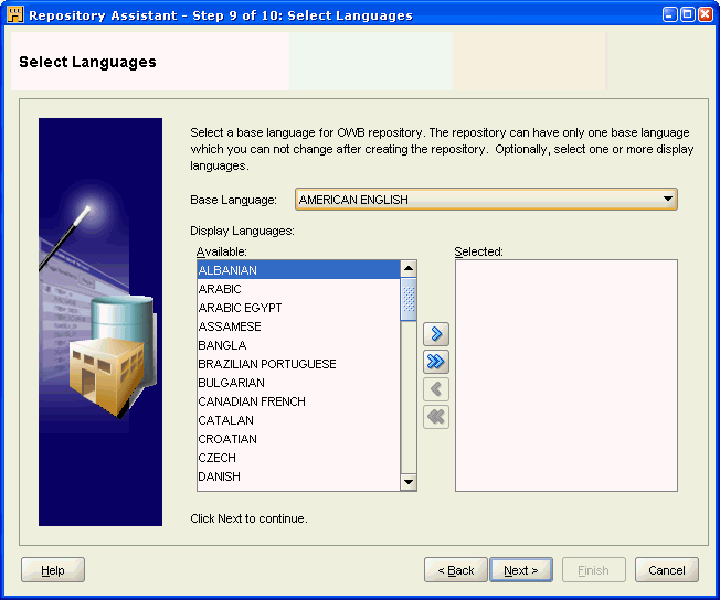

  12. On the Select Languages screen, select the Base Language from the menu.
    [Optional] You may also select additional Display Languages from the list of Available languages on the left-hand side, and move them to the list of Selected languages on the right side.
    Click Next.
    Description of workspace_11.gif follows

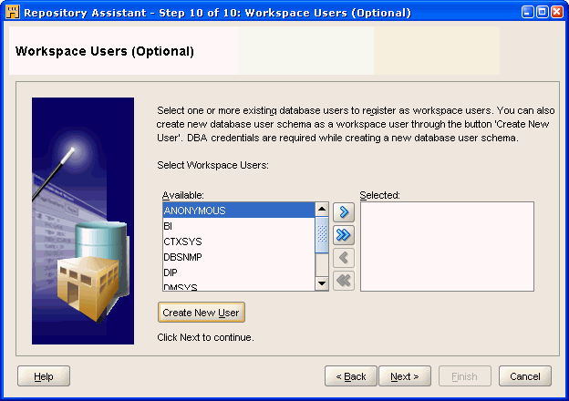

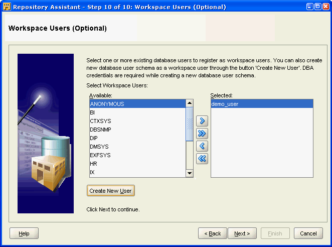

  13. On the Workspace Users (Optional) screen, select the appropriate existing users from the Available list add them to the Selected list.
    [Optional] Click Create New User to make new users who can access OWB. This takes you to step 14.
    Click Next. This takes you to step 16.

  14. [Optional] In the Create New Database User screen, enter the following:
    • User Name (demo_user)
    • Password
    • Re-enter Password
    Click OK.
    Note that DBA User Name (system) and DBA User Password are disabled fields and cannot be edited.

  15. In the Workspace Users (Optional) screen, click Next.

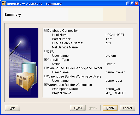

  16. On the Summary screen, click Finish.
    Description of workspace_15.gif follows
