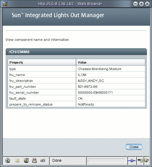

3. Click on the name of a component in the Component Management Status table.
A dialog box appears with information about the selected component.
FIGURE 6-2 Component Information Dialog
