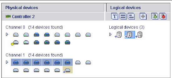

Click on a logical drive to highlight the disk drives that comprise it in the Physical Devices View. In the following figure, six disk drives (plus one hot-spare) comprise the selected RAID 5 logical drive.
FIGURE 3-5 Relationship Between Physical and Logical Devices
Figure shows highlighting over a logical drive and six physical devices.
