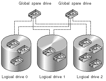

Global Spare Drives
A global spare drive is available to support all logical drives. If a member drive in any logical drive fails, the global spare drive joins that logical drive and automatically starts to rebuild.
  FIGURE 1-2 Global Spare
Figure showing the global spare configuration.

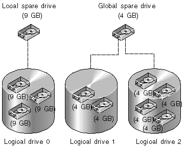

Using Both Local and Global Spare Drives
In FIGURE 1-3, the member drives in logical drive 0 are 9-Gbyte drives, and the members in logical drives 1 and 2 are all 4-Gbyte drives.
A local spare drive always has higher priority than a global spare drive. If a drive fails and a local spare and a global spare drive of sufficient capacity are both available, the local spare drive is used.
  FIGURE 1-3 Mixing Local and Global Spares
Figure showing the mixing local and global spares configuration.
In FIGURE 1-3, it is not possible for the 4-Gbyte global spare drive to join logical drive 0 because of its insufficient capacity. The 9-Gbyte local spare drive is used for logical drive 0 once a drive in this logical drive fails. If the failed drive is in logical drive 1 or 2, the 4-Gbyte global spare drive is used automatically.
