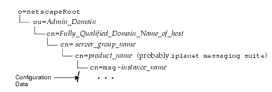

  3. Find the location of the iPlanet Messaging Server configuration data from Directory Server 4.16.
  4. The configuration parameters are stored under the distinguished name defined by the local.ldapsiedn parameter in instance_root/config/msg.conf. This value is depicted in Figure 1.
    Figure 1  Location of Messaging Server Configuration Data on Old Server
    Example:
    dn: cn=msg-sesta, cn=iplanet messaging suite, cn=Server Group, cn=messaging1.siroe.com, ou=AdminDomain, o=netscapeRoot
