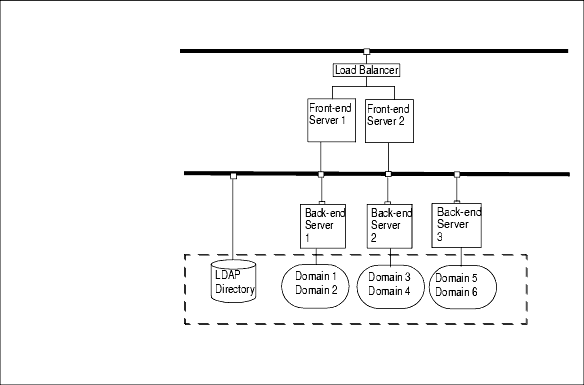

Multiple Servers - Migrate Directly to Native Mode
This direct-migration scenario makes the following assumptions:
Figure 2-1 shows a simple example of a distributed environment. Two front-end servers handle incoming and outgoing traffic and three back-end servers look up entries in portions of the LDAP directory. Each back-end server manages two domains in the directory.
Figure 2-1
Illustrates a two-tiered, multiple-server environment
Two-tier, Multiple-Server Environment
Characteristics of This Scenario
Migration Steps
The following steps outline how to migrate a two-tiered, multiple-server environment directly to Schema 2, native mode:

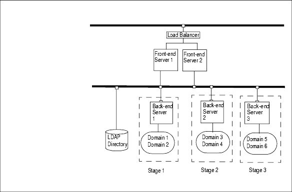

Multiple Servers - Migrate Incrementally to Native Mode
This incremental-migration scenario makes the following assumptions:
This scenario uses the sample distributed environment shown in Figure 2-3.
Deployments Suitable for Incremental Migration
The scenario described in this section uses the sample distributed environment shown in Figure 2-3.
In this example, each back-end server manages a unique portion of the LDAP directory, as follows:
This structure lends itself to incremental migration because each server can be upgraded and configured separately, and its corresponding domains can be migrated separately.
In the scenario, the migration proceeds in three stages corresponding to the three server-domain groups listed above.

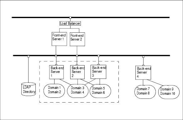

Cross-Domain Deployment—Not Recommended for Incremental Migration
If all the servers in your installation manage across domain boundaries (if multiple servers share access to each domain), your installation might not be a good candidate for incremental migration.
For example, suppose your installation contains two back-end servers in the following configuration:
This installation should migrate directly (both servers, the entire LDAP directory), not incrementally.
A Complex Deployment Suitable for Incremental Migration
In a complex deployment with many back-end servers, you might still be able to migrate groups of domains incrementally. Your installation must fit the guidelines described in Rules for Incremental Migration.
Figure 2-2 shows one part of a large, complex server configuration and LDAP directory. It is assumed that the entire deployment includes many additional servers and domains not shown in the figure.
Figure 2-2
Illustrates a portion of a complex multiple-server deployment suitable for incremental migration.
A Portion of a Multiple-Server Deployment Suitable for Incremental Migration
In the example shown in Figure 2-2, Back-end servers 1, 2, and 3 manage across domain boundaries, as follows:
No individual server exclusively manages a single domain.
Taken together, however, Back-end servers 1, 2, and 3 manage a unique set of domains that can be migrated incrementally.
In this example, when you run the Schema Migration Utility, you can specify Domains 1, 2, 3, 4, 5, and 6 in the migration to Schema 2. You can then reconfigure Back-end servers 1, 2, and 3 to use Schema 2.
Similarly, you could migrate and configure other groups of domains and servers that form distinct units within the deployment. In the example shown in Figure 2-2, Back-end Server 4 and the domains it manages might be candidates for another stage in an incremental migration.

Migration Steps
The following steps outline how to migrate a two-tiered, multiple-server deployment to Schema 2, native mode in three stages.
Figure 2-3 shows the sample configuration of servers and domains used in this scenario.
Figure 2-3
Illustrates a two-tiered, multiple-server environment in which the directory is migrated incrementally.
Two-tier, Multiple-Server Environment: Incremental Migration
The steps for incremental migration are as follows:

Multiple Servers - Migrate Incrementally to Compatibility Mode, Then to Native Mode
For a discussion of the conditions best suited for migrating your installation incrementally, see Deployments Suitable for Incremental Migration.
Migration Steps
The following steps outline how to migrate a two-tiered, multiple-server environment to Schema 2, native mode in stages.
