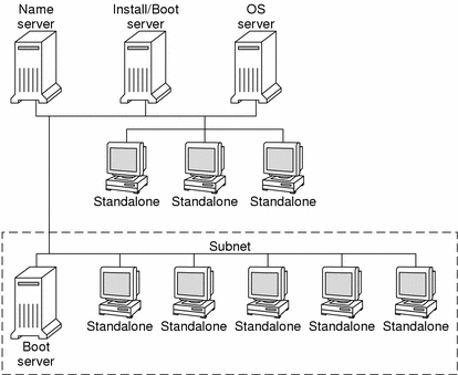

Boot server - A server system that provides client systems on the same network subnet with the information that they need to boot in order to install the operating environment. A boot server and install server are typically the same system. However, if the system on which the Solaris 9 software is to be installed is located in a different subnet than the install server and you are not using DHCP, a boot server is required on that subnet.

Figure 10-1 illustrates the servers that are typically used for network installation.
When using Dynamic Host Configuration Protocol (DHCP), you do not need to create a separate boot server. After you have created the install server, you add clients to the network with the add_install_client command and the -d option. The -d option enables you to set up client systems for Solaris installation from the network by using DHCP. DHCP provides the network parameters that are necessary for installation. For information on DHCP options for installation parameters, see "Supporting Solaris Network Installation with the DHCP Service (Task Map)" in System Administration Guide: IP Services.
