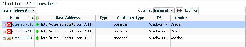

3.2.4 Viewing Tables
Tables are shown in the main area of the console.
Controls situated above the table allow you to filter the contents of the table, to change the columns shown, or to re-size columns to fit data. You can also sort columns, change column widths, and move columns.
  • To view sorting options for a given column, pass the cursor over the column heading. A pop-up will inform you of your options.
  • To change column widths, place the cursor on the line separating column headings until the resizing icon appears, then drag the icon to change the width of the column.
  • To move columns in different positions, click the column heading and drag to the desired position.
Any changes you make to a table will be lost when you close or refresh your browser. To save a modified view, you must choose View > Save current view from the menu. After naming and saving the view, it will be listed under My Views in the navigator.

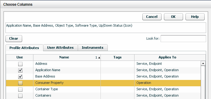

3.3.1 Modifying Tables
Controls for modifying tabular displays (by adding or deleting columns) and for resizing columns are shown just above table views. The figure below shows the column chooser and its drop-down list. It also shows the sizing control, which allows you to resize columns so that all columns are visible in the table.
Figure explained in text.
Choose No Columns to display no columns. If you select Choose Columns.... Business Transaction Management displays a tool you can use to add or delete columns.
Choose Columns tool . Its use is described in text.
The Choose Columns tool shows the attributes that are currently chosen from any of the three tabs: Profile Attributes, User Attributes, and Instruments.
The top box lists all columns that are currently chosen from any of the three tabs: Profile Attributes, User Attributes, and Instruments.
You can select columns to add or subtract in three tabbed categories. To start, click a tab, and use the Look for filter to narrow the options shown if needed.
  • To add a column click the box in the Use column for the desired attribute or instrument.
  • To remove a column click the checked box in the Use column for the desired attribute or instrument.
User attributes are used only in graphic displays. They dictate whether clients are shown for endpoints or services.
The time control displayed for the Instruments tab applies to all instruments chosen, you can select more than one interval for instruments.
When you are satisfied with your changes, click OK. Look over the resulting view to make sure you have the information you need. You might still want to move or resize columns before saving this as a permanent view.

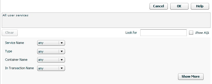

3.3.2 Using the Custom Data Explorer to Create a View
By default, the console displays objects and relationships thought to be most useful to most users. If the default views do not include the objects or relationships that interest you, use the custom data explorer to display any object known to the system and its relationships to other associated objects. Using this information, you can create your own custom views.
To use the Custom Data Explorer, choose Explorer > Custom Data Explorer from the Navigator.

You could now use the Column Chooser tool to display attributes and instruments for these primary and associated objects.

3.4.3 Using the Filter Tool
The Filter tool allows you to filter objects according to their salient characteristics, which varies according to the item chosen in the Navigator. Although the basic structure of the Filter tool does not change as the target object changes, the criteria you can select does change depending on whether the filter is used to modify the view of services, containers, policies, consumers, and so on.
In addition to the predefined filters, which are shown in a drop list next to the Filter link, you can also click on the link to open the Filter tool and obtain a richer choice of filtering criteria.
Note: You cannot filter condition alerts, observers, or schedules.
To open the filter tool, click on the Filter link in any view where it is displayed.
Business Transaction Management displays a dialog like the following:
Description of filter_link.gif follows
The tool initially presents a short form that allows you to define a filter that references the most common criteria for the object of interest. The domain of objects for which you are creating a filter is displayed in the text box. For example, in the figure above, the text box informs you that you are creating a filter for all user services. To display additional criteria, click the Show More button.
As you select criteria for a query, either from the short form or from the longer form (Show More), Business Transaction Management translates your choices into an AQL expression that it uses to search the database. You can see that AQL query statement in the text box at the top of the tool by clicking the Show AQL check box.
You can use this feature to define AQL expressions that you can pass to CLI commands that use the -filterQuery flag. Simply use the filter tool controls to define your criteria, then copy and paste the AQL expression into the CLI command. Remember to enclose the query in quotation marks if it includes spaces.
When you are done selecting the criteria of interest, click the OK button to use this filter to modify the current view. See Section 3.3.3, "Saving a View" for instructions on saving your view.
