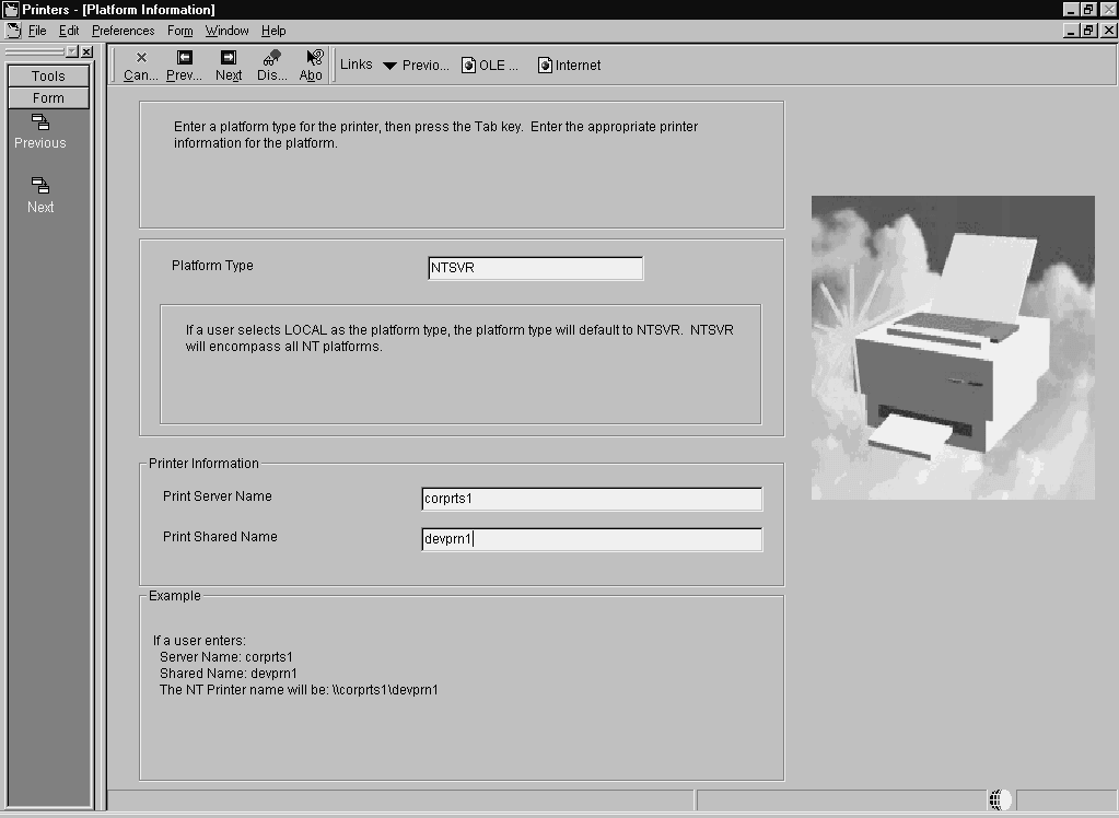

    The Platform Information form appears. The platform type may appear by default, depending on the operating system on which Release 9.1 is running.
    Surrounding text describes add_printer_win.gif.
  4. On Platform Information, complete these fields:
    Field Description
    Platform Type Enter the platform type on which you are installing or use the visual assist button to select a platform type.
    Print Server Name Enter the name of the print server for the printer you are setting up. Valid characters are all alpha (A-z), numeric (0-9), period ( . ), and dash ( - ). Release 9.1 uses this name, along with the print shared name, to create the printer name, which is unavailable for modification on the subsequent form.
    For printing reports to a non-network printer, leave this field blank.
    Print Shared Name Enter the share name of the printer you are setting up. All characters are valid except the forward slash ( \ ) and the backslash ( \ ). Release 9.1 uses this name, along with the print server name, to create the printer name, which is unavailable for modification on the subsequent form.

    Surrounding text describes printer_setup.gif.

  23. When finished entering information for the printer on the Printer Setup form, click End.
    Release 9.1 saves the new printer setting and returns you to the first form in the Printers application.
    Field Description
    Platform Type Define the type of physical hardware on which the database resides.
    Server Name Define the computer that receives documents from clients.
    Printer Name Enter a name that refers to a shared resource on a server. Each shared directory on a server has a share name, which is used by clients to refer to the directory.
    Printer Model Define these attributes for your printer:
    • Printer Model
    • Printer Location
      Designates the physical location of the printer
    Paper Type Enter a user defined code (H98\PT) to define the type of printer paper, such as letter or legal. For example, LETTER, LEGAL, and A4.
    Paper Width Define the width of the paper for this paper type. This value is in the unit of measure specified by Unit of Measure.
    Paper Height Define the height of the paper for this paper type. This value is in the unit of measure specified by Unit of Measure.
    Unit of Measure Enter a user defined code (00\UM) to define the quantity in which to express an inventory item. For example, CS (case) or BX (box). Form-specific information indicates the unit of measure in which the paper height and width are entered. For example, IN = Inches and MM = Millimeters.
    Columns Per Page Define the number of columns per page. For example, 80 or 132.
    Characters Per Inch (CPI) Define the horizontal printing density in characters per inch.
    You should only define values that are supported by your printer.
    Line Per Page Define the number of lines per page. For example, 60 or 66.
    Line Per Inch (LPI) Define the line spacing in lines per inch.
    Values are:
    4 - IBM 5219, 5224, 5225, and 3287 printers only
    6 - IBM 5224 printer only
    8 - IBM 5224 printer only
    9 - IBM 5225 printer only
    Note: The standard computer print is 6 LPI and 10 CPI. If you are printing on 8 1-2-inch x 11-inch paper, typically you would specify 8 LPI and 15 CPI.
    Maximum Number of Output Tray Define the maximum number of paper trays available on the printer you are setting up.
    Output Tray Name Define the output tray for a given batch print job.
