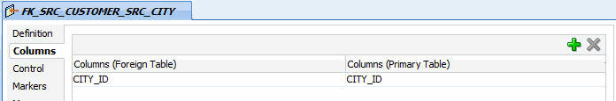

  5. In the Reference Editor, go to the Columns tab.
  6. On the Columns tab, click Add as shown in Figure 5-5.
    Figure 5-5 Columns tab of the Reference Editor
    Surrounding text describes Figure 5-5 .
    A new row is inserted in the columns table.
  7. In this step you define the matching columns:
    • Click on the row that appears. This will bring up a drop-down list containing all of the columns in the appropriate table.
    • From the Columns (Foreign Table) list, select CITY_ID.
    • From the Columns (Primary Table) list, select CITY_ID.
    Figure 5-6 shows the Columns tab of the Reference Editor with the selected matching columns.
    Figure 5-6 Columns tab of the Reference Editor with matching columns
    Surrounding text describes Figure 5-6 .
    Note that in this example the Foreign Table is SRC_CUSTOMER and the Primary Table is SRC_CITY. Note also that it is not required for foreign keys that the column names of the Foreign Table and the Primary Table match. It just happens that they do in this example.
