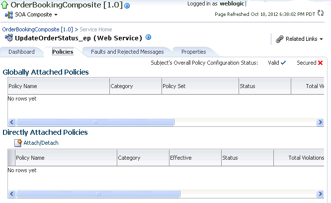

    The Dashboard page for the selected SOA composite application appears. The Services and References section of this page displays the binding components being used in the application.
  2. In the Services and References section, select a service or reference.
  3. Click Policies.
    The Policies page enables you to view the globally-attached and directly-attached policies, and to attach or detach security policies to and from a service or reference binding component:
    • The Globally Attached Policies table displays the globally-attached policy name, the policy set, the category (Management, Reliable Messaging, MTOM Attachment, Security, or WS Addressing), the violations since the SOA Infrastructure was last restarted, and the authentication, authorization, confidentiality, and integrity failures since the SOA Infrastructure was last restarted.
      Policy sets provide a means to attach policies globally to a range of endpoints of the same type. Attaching policies globally using policy sets enables an administrator to ensure that all subjects are secured in situations in which the developer, assembler, or deployer did not explicitly specify the policies to attach. Policies that are attached using a policy set are considered externally attached. For information about creating and managing policy sets, see Chapter "Creating and Managing Policy Sets" of Oracle Fusion Middleware Security and Administrator's Guide for Web Services.
    • The Directly Attached Policies table displays the directly-attached policy name, the policy reference status (enabled or disabled), the category, the violations since the SOA Infrastructure was last restarted, and the authentication, authorization, confidentiality, and integrity failures since the SOA Infrastructure was last restarted.

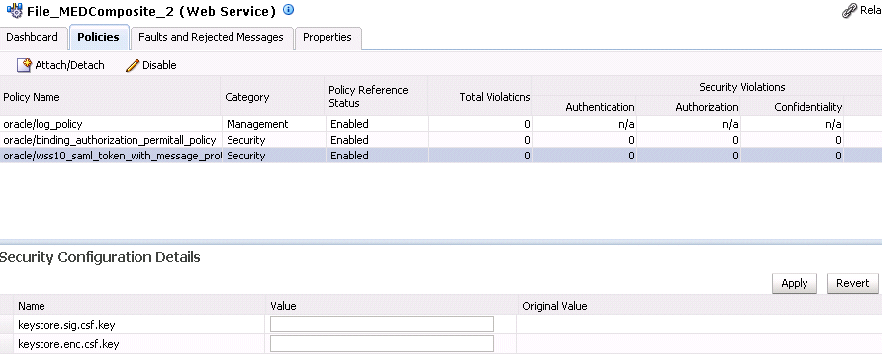

38.1.1 Override Policy Configuration Property Values
Your environment may include multiple servers with the same policies. However, each server may have their own specific policy requirements. To satisfy your runtime requirements, you can override the property values for some management and security policies attached to service and reference binding components.
  1. Follow the instructions in Section 38.1, "Managing Binding Component Policies" to attach a policy to a service or reference binding component.
  2. Select the attached policy in the table.
    The Security Configuration Details table is displayed at the bottom of the page.
    Description of bc_policies2.gif follows
  3. In the Value field, enter a value to override the default value in the Original Value column.
  4. Click Apply.
For more information on overriding policy values, see Oracle Fusion Middleware Security and Administrator's Guide for Web Services.

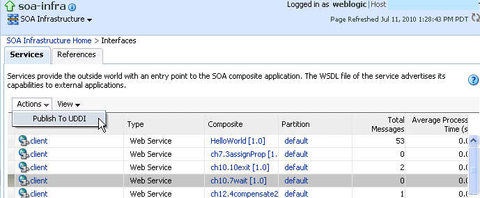

  1. Access this page through one of the following options:
    From the SOA Infrastructure Menu... From the SOA Folder in the Navigator...
    1. Select Services and References.
    1. Right-click soa-infra.
    2. Select Services and References.
    The Services page displays details about the names and types of the services, the SOA composite applications in which the services are used, the partition in which the composite is deployed, the total number of messages processed, the average processing time, and the number of faults occurring in the services.
  2. In the Service table, select a service to publish to the UDDI registry.
  3. From the Actions list, select Publish To UDDI.
    Description of bc_pubuddi.gif follows

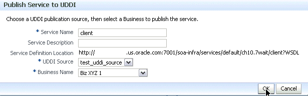

    The Publish Service to UDDI dialog appears.
  4. Enter the following information:
    Field Description
    Service Name
    Displays the name of the selected service.
    Service Description
    Enter an optional description of the selected service.
    System Definition Location
    Displays the WSDL URL to publish to the UDDI registry. For example:
    http://myhost.mycompany.com:7001/soa-infra/services/default/HelloWorld/client?WSDL
    UDDI Source
    Select the UDDI publishing source from which to register the service.
    Business Name
    Select a business to publish the service. This is the name of the data structure in the UDDI registry. It is assumed that the business has already been registered in the UDDI registry.
    When complete, the Publish Service to UDDI dialog looks similar to the following:
    Description of bc_pubuddi2.gif follows
  5. Click OK.
