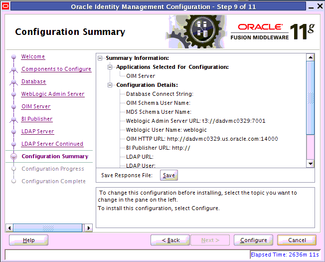

B.9 Configuration Summary
This screen displays a list of the applications or components you have selected for configuration. It includes the following information:
  • Location of your installation
  • Disk space that will be used for the installation
  • Applications or components you have selected for configuration
  • Configuration choices you made on different screens in the Oracle Identity Manager Configuration Wizard
Figure B-9 Configuration Summary Screen
Description of Figure B-9 follows
Description of "Figure B-9 Configuration Summary Screen"
Review this summary screen.
Additionally, you can select to create a response file from your installation selections by clicking on the Save button in the Save Response File field. A response file can be used for silent or non-interactive installations of software requiring no or very little user input.
Click Configure to start configuring the selected Oracle Identity Manager components.
