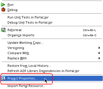

  12. Now you need to change the context root of the portal application. Right-click Portal project and choose the Project Properties menu item, as shown in Figure 3-12.
    Figure 3-12 The Project Properties Menu Item Selected to Change the Context Root of the Application
    Description of Figure 3-12 follows
    Description of "Figure 3-12 The Project Properties Menu Item Selected to Change the Context Root of the Application "

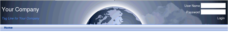

In the upper right corner of the Home page, in the User Name field (Figure 3-16), you can log into the Home page. Enter weblogic as the User Name. (Note that the weblogic user is seeded in the integrated WebLogic Server.) In the Password field, enter weblogic1.
Figure 3-16 Enter User Name and Password To Log in to Home Page
Description of Figure 3-16 follows
Description of "Figure 3-16 Enter User Name and Password To Log in to Home Page"
