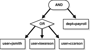

Pre-Process Filtering
Pre-processing filters are used to parse a filter and to apply it to a modified search or transform it to another format that the target of the search can understand. Think of pre-processing filters as converting an LDAP filter to an SQL WHERE clause, which to do so, you must traverse the filter object. For example, consider the conversion of the following LDAP filter to an SQL WHERE clause:
(&(|(user=jsmith)(user=lswanson)(user=ccarson))(dept=payroll))
The preceding LDAP filter states All records where the user is jsmith, lswanson or ccarson and whose department is payroll. Figure 18-1 shows a visual representation of this LDAP filter:
Figure 18-1 Visual Representation of an Example LDAP Filter
Visual representation of an LDAP filter
To translate the filter shown in Figure 18-1 into an SQL WHERE clause, you use a recursive function that traverses the tree. The example filter is represented in Oracle Virtual Directory as a hierarchy of Filter objects, which contain collections of other Filter objects to create a traversable tree. The filter shown in Figure 18-1 will have the object model shown in Figure 18-2, where the name of the class used to represent the filter element is below the operation or operand:
Figure 18-2 Example Object Model of a Filter
To traverse the tree shown in Figure 18-2, a recursive method is used that queries the getSelector() method of the filter to determine what type of filter it is. After the type for the filter is determined, its value must be extracted by using a getFilterType method. For example, if the filter is an equality filter, such as user=jsmith, the value of the filter object would come from currentFilter.getEqualityMatch(). In this case the return value is an AttributeValueAssertion, which stores the attribute name and value as an Oracle. Once retrieved, the values can be converted into String objects. Filter_and and Filter_or objects return java.util.Iterator classes for iterating through the child filters that are being operated on.
LDAP filters do not limit you to two terms per relation. The OR portion has three operands. Since SQL only allows two operands per operation, the tree in Figure 18-2 must be converted to a binary tree.
Figure 18-3 Breaking an OR Function
Breaking an OR function.
In Figure 18-3, the OR operation is broken up into two separate OR operations. The final WHERE clause from the filter is ((user=jsmith) OR ((user=lswanson) OR (user=ccarson))) AND (dept=payroll). The LDAP prefix notation has been transformed into a SQL like infix notation with only two operands per operation. Example 18-8 shows the source code for the transformation:
