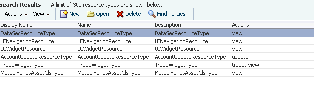

4.3.3 Searching Resource Types
To search Resource Types, proceed as follows:
  1. Select from the following methods to display the Search Resource Types page as in Figure 4-3.
    • In the Navigation Panel, expand the Application node and double-click Resource Types.
      Alternately, right-click Resource Types and select Open.
    • In the Home area, select the appropriate Application Name and click Search under Resource Types.
      Figure 4-3 Searching for Resource Types
      Description of Figure 4-3 follows
      Description of "Figure 4-3 Searching for Resource Types"
  2. Enter the following query parameters:
    • Display Name: Select an operator from the list and enter a string to match.
    • Name: Select an operator from the list and enter a string to match.
    • Actions: Select an operator from the list and enter a string to match.
    Optionally, select from the Saved Search drop-down list of previously saved searches. Its query parameters automatically populate the search fields. Select Personalize... to set options for previously saved searches.
  3. Optionally, click Save... to name the current query parameters.
    The named search is added to the Saved Search list.
  4. Click Search.
    All results matching the query specifications are displayed in the Search Results table as illustrated in Figure 4-4.
    Figure 4-4 Resource Type Search Results
    Description of Figure 4-4 follows
    Description of "Figure 4-4 Resource Type Search Results"
