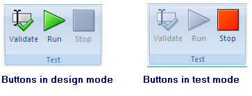

To test your integrated Excel Workbook, click the Run button on the Oracle ADF tab, and click the Stop button to return to the design mode. Figure 13-1 shows the buttons of the Oracle ADF tab in design mode and in test mode.

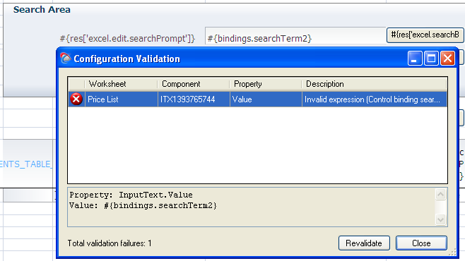

    The Configuration Validation dialog appears listing all your warnings and errors.
  4. If any warning or error is displayed, click to select it. A description of the warning or error message is displayed in the dialog.
    For example, Figure 13-2 illustrates a validation failure message of an invalid EL expression.
    Figure 13-2 Invalid EL Expression Resulting in a Validation Failure
    Configuration Validation dialog box with an error message
    If no warning or error appears, click Close to close the dialog.
You may continue to keep the Configuration Validation dialog open while you resolve the validation failures. To verify whether you have resolved an error or a warning, click Revalidate to run the validation rules again.

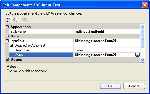

13.3.3 How to Fix Validation Failures
When you validate your workbook, you might get validation failures or warning messages, which you can fix easily by following these steps:
  1. Identify the component that gave the error or warning message.
    In Figure 13-2, note that the ADF Input Text component generated the error. From all Input Text components in the worksheet, identify the component that uses searchTerm2 expression.
  2. Open the property editor of the component.
  3. Navigate to the invalid property value identified by the full property context path.
  4. Edit the property value to resolve the validation failure.
    Figure 13-3 illustrates the ADF InputText component property editor and its invalid EL expression.

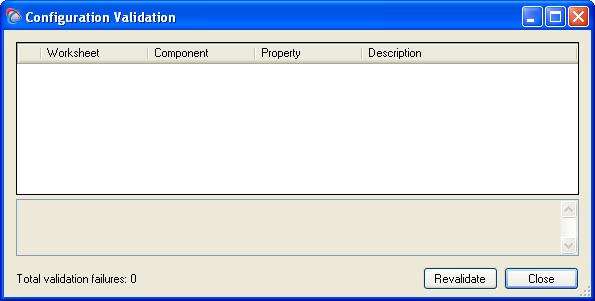

  5. Revalidate the workbook to verify whether the validation failure has been resolved. Click Revalidate to run the validation rules again.
  6. After fixing all validation failures, click Close to close the Configuration Validation dialog.
    Figure 13-4 illustrates the Configuration Validation dialog with no warnings or error messages.
    Figure 13-4 Configuration Validation Dialog with No Validation Failure Messages
    Configuration Validation dialog box with no errors

As you configure your Excel workbook to integrate with a Fusion web application, you can switch to test mode from design mode to test the functionality that you add to the workbook. You use the Oracle ADF tab to switch to test mode from design mode and from design mode to test mode.
Test mode enables you to test the functionality of your integrated Excel workbook as you configure it incrementally. It also enables you to view the integrated Excel workbook from the end user's perspective, as test mode corresponds to what end users see when they view and execute the published integrated Excel workbook. The difference between an integrated Excel workbook in test mode and a published integrated Excel workbook is that the ADF Desktop Integration task pane is not available to users of the published integrated Excel workbook.
For more information about test mode and design mode, see Section 5.1, "About Development Tools."
There are some differences between the test mode and the runtime mode when you run the integrated Excel workbook. Table 13-1 lists these differences.
Table 13-1 Differences between Test mode and Runtime mode
Test mode Runtime mode
Does not perform tamper check
Performs tamper check
Does not display the connection confirmation dialog
Displays the connection confirmation dialog
Displays the Oracle ADF ribbon tab
Does not display Oracle ADF tab
Allows you to switch back to design mode
Does not allow you to switch back to design mode
