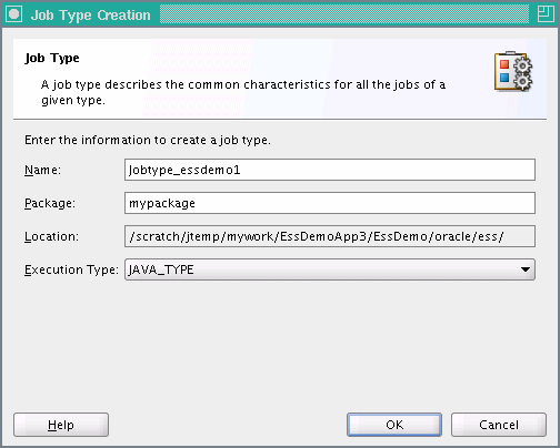

An Oracle Enterprise Scheduler job type specifies an execution type and defines a common set of parameters for a job request.
To create a job type:
In the Application Navigator, select the EssDemo project.
Press Ctrl-N. This displays the New Gallery.
In the New Gallery, select the All Technologies tab.
In the New Gallery, in the Categories area expand Business Tier and select Enterprise Scheduler Metadata.
In the New Gallery, in the Items area select Job Type as shown in Figure 5-13.
Click OK. This displays the Create Job Type dialog.
In the Create Job Type dialog, specify the following:
In the Name field, enter a name for the job type. For this example, enter the name: Jobtype_essdemo1
In the Package field, enter a package name. For example, enter mypackage
In the Execution Type field, from the dropdown list select JAVA_TYPE as shown in Figure 5-14.
Click OK. This creates the Jobtype_essdemo1.xml
file and Oracle JDeveloper displays the Job Type page.

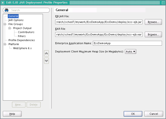

In the Create Deployment Profile - EJB JAR File dialog, in the Deployment Profile Name field enter ess-ejb
Click OK. This displays the Edit EJB JAR Deployment Profile Properties dialog.
In the Edit EJB JAR Deployment Profile Properties dialog, in the Enterprise Application Name field enter EssDemoApp
, as shown in Figure 5-19.

To create metadata for the back-end hosting application:
In the Application Navigator, right-click the SuperEss project and choose New.
Expand Business Tier, select Enterprise Scheduler Metadata and then Job Type, and click OK.
In the Name field, enter HelloWorldJobType
In the Package field, enter /oracle/apps/ess/howto/
Select JAVA_TYPE from the Execution Type dropdown list.
Click OK. This creates the HelloWorldJobType.xml
file and Oracle JDeveloper displays the file in the editor.
In the editor window, set the description to HelloWorld Example
Set the class name to oracle.apps.ess.howto.HelloWorldJob

The EJB Java archive file includes descriptors for the Java job implementations.
To assemble the EJB JAR file for the back-end hosting application:
In Application Navigator, right-click the SuperEss project and select Rebuild SuperEss.jpr.
In the Messages Log you should see a successful compilation message, for example:
[3:40:22 PM] Successful compilation: 0 errors, 0 warnings.
In Application Navigator, right-click the SuperEss project and choose New.
In the New Gallery, expand General, select Deployment Profiles and then EJB JAR File, and click OK.
In the Create Deployment Profile dialog, set the Deployment Profile Name to JAR_SuperEssEjbJar
Optionally, in the Edit EJB JAR Deployment Profile Properties dialog, expand File Groups, expand Project Output, and select Filters and clear the essmeta check box.
Clearing this check box prevents the JAR file from being cluttered with unnecessary XML files and reduces the overall memory footprint.
On the EJB JAR Deployment Profile Properties dialog, click OK.
On the Project Properties dialog, click OK.

To assemble the EJB JAR File for the front-end submitter application:
On the Edit EJB JAR Deployment Profile Properties dialog, click OK.
