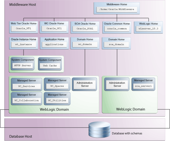

2.3.1 A Typical Patching Scenario
Consider a common, non-distributed Fusion Middleware topology for Oracle SOA Suite, as shown in Figure 2-1:
OPatch can be used to patch any Fusion Middleware product, even though only a few are shown in this example. OPatch can not be used to patch Oracle WebLogic Server.
Figure 2-1 Common Fusion Middleware Topology for Oracle SOA Suite and Oracle WebCenter
Surrounding text describes Figure 2-1 .
Suppose you have a problem in the SOA Domain. Below is a typical patching process:

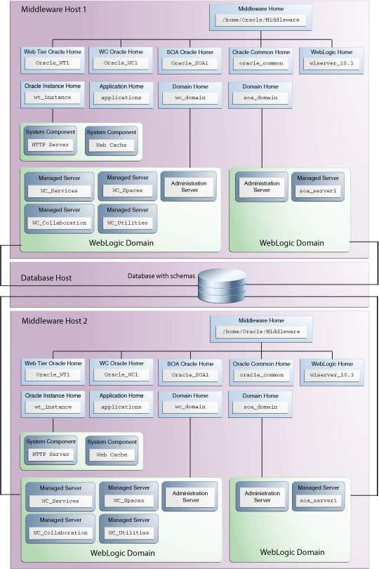

2.3.3.1 Patching with a Local Middleware Home
Consider the environment shown in Figure 2-2. This is a distributed environment, where you have identical topologies on separate machines, each with its own local Middleware home and Fusion Middleware products inside the Middleware home:
Figure 2-2 Distributed Fusion Middleware Topology for Oracle SOA Suite and Oracle WebCenter
Surrounding text describes Figure 2-2 .
If you encountered a problem in the SOA domain, you would have to patch the corresponding Oracle home on each machine separately, according to the instructions in the README file. After you patch the SOA Oracle home on "Middleware Host 1," for example, you must then repeat the same procedure on "Middleware Host 2."

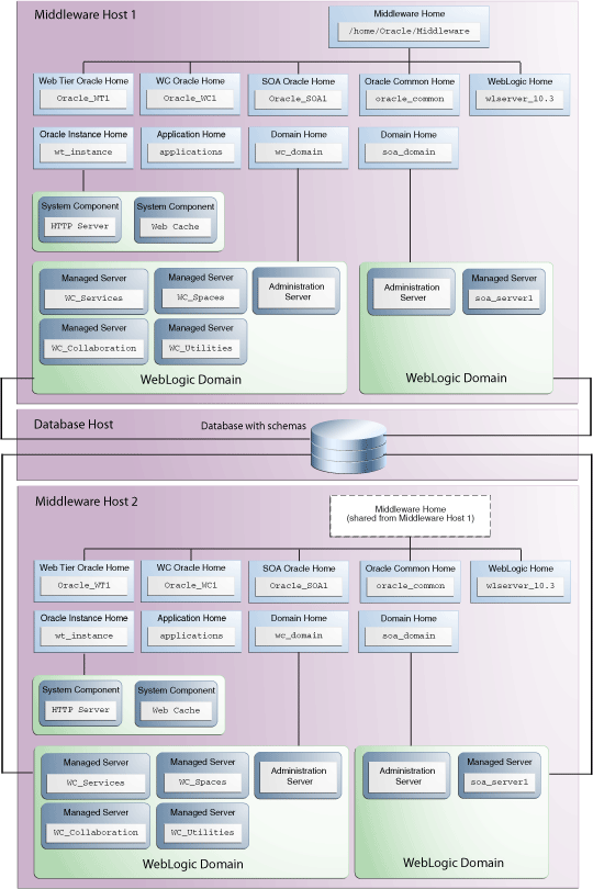

2.3.3.2 Patching with a Shared Middleware Home
Consider the environment shown in Figure 2-3. This is also a distributed environment, where you have identical topologies on separate machines, but the Middleware home on "Middleware Host 2" is shared or NFS mounted:
Figure 2-3 Distributed Fusion Middleware Topology for Oracle SOA Suite and Oracle WebCenter
Surrounding text describes Figure 2-3 .
In this topology, if you encountered a problem in the SOA Domain, you would only need to patch the SOA Oracle home on either "Middleware Host 1" or "Middleware Host 2" in accordance with the instructions in the README file, and OPatch would automatically patch all of the matching Oracle homes that share the same Middleware home.
