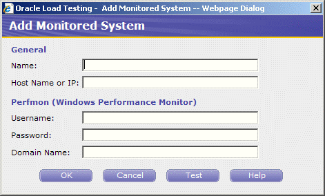

  4. Click Add next to Monitored System.
    Figure 4-16 Add Monitored System Dialog Box
    Add Monitored System dialog box
    Description of "Figure 4-16 Add Monitored System Dialog Box"
    If you have additional systems to monitor you can specify the information here to add the system to the ServerStats Configuration.

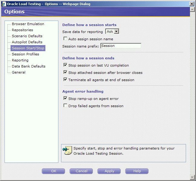

The data generated by a Oracle Load Testing Autopilot session can be saved to the Oracle Load Testing database for post-session analysis. The Session Start/Stop options let you specify if Oracle Load Testing should save the data.
  1. Select Options from the Tools menu and then select Session Start/Stop.
    Figure 4-17 Session Start/Stop Options Dialog Box
    Session Start/Stop Options dialog box
    Description of "Figure 4-17 Session Start/Stop Options Dialog Box"
  2. Set the Save data for reporting option to Ask.
  3. Select the Terminate all agents at end of session checkbox.

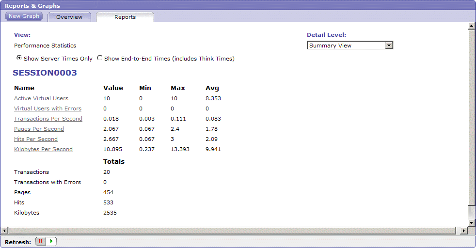

Click on the Reports tab to view the Performance Statistics report. The Performance Statistics report shows a summary of the performance data for the running virtual users.
Figure 4-22 Performance Statistics Report
Description of "Figure 4-22 Performance Statistics Report"
The statistics show the values for the following performance categories:
<Session Name> Current
  • Active Virtual Users - the number of virtual users currently running in the Autopilot.
  • Virtual Users with Errors - the number of virtual users with errors.
  • Transactions Per Second - the number of times the virtual user played back the script per second.
  • Pages Per Second - the number of pages returned by the server per second. A "page" consists of all of the resources (i.e. page HTML, all images, and all frames) that make up a Web page.
  • Hits Per Second - the number of resource requests to the server per second. Each request for a page, individual images, and individual frames is counted as a "hit" by Oracle Load Testing. If Oracle Load Testing does not request images from the server (as specified in the Download Manager), images are not included in the hit count. The Hits Per Second and Pages Per Second counts will be the same if images are not requested and there are no frames in the page.
  • Kilobytes Per Second - the number of kilobytes transferred between the server and browser client per second.
<Session Name> Totals
  • Transactions - the total number of times the virtual user played back the virtual user profile.
  • Transactions with Errors - the total number of virtual user profile iterations that had errors.
  • Pages - the total number of number of pages returned by the server.
  • Hits - the total number of resource requests to the server.
  • Kilobytes - the total number of kilobytes transferred between the server and browser client.
Performance by Profile and Timer
  • <Profile Name> - the latest, minimum, maximum, and average performance for the virtual user profile in seconds.
  • <Timer Name> - the latest, minimum, maximum, and average performance for the server response timers in seconds. Server Response timers are added to scripts using Oracle OpenScript.
Performance by Profile and VUs
  • <Profile Name> # VUs - shows the time it took to run the virtual user profile with the indicated number of virtual users running. When ramping up virtual users, Performance by Profile and VUs values are added when additional virtual users start running. Once additional Performance by Profile and VUs values are added, the previous Performance by Profile and VUs values are no longer updated. For example, the statistics show elapsed time values for each profile for three, six, and nine virtual users. The <profile name> 3 VUs values are updated only while three virtual users are running. Once the Autopilot ramps up to run six virtual users, the <profile name> 3 VUs values stop updating and the <profile name> 6 VUs values are added and are updated while six virtual users are running. Once the Autopilot ramps up to run nine virtual users, the <profile name> 6 VUs values stop updating and the <profile name> 9 VUs values are added and are updated while nine virtual users are running.

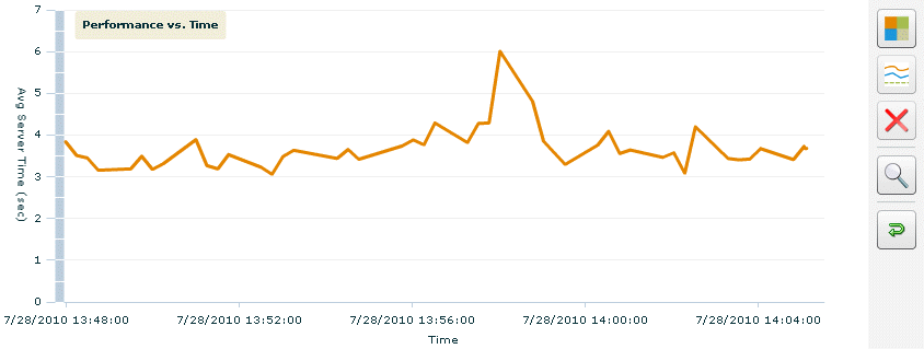

  4. Select the Performance Vs. Time in the Default Graphs dropdown of the Overview tab.
    Figure 4-26 Performance Vs. Time Report
    Performance Vs. Time report
    Description of "Figure 4-26 Performance Vs. Time Report"
    This graph shows the average run time for the active virtual users running each profile over time.

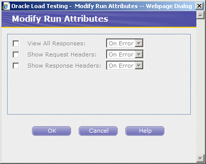

  3. Select Modify Run Attributes. Oracle Load Testing opens a dialog box for changing the run attributes for the selected virtual user.
    Figure 4-29 Modify Run Attributes Dialog Box
    Modify Run Attributes dialog box
    Description of "Figure 4-29 Modify Run Attributes Dialog Box"
    You can change the attributes of each virtual user individually.
  4. Click Cancel to close the dialog box.

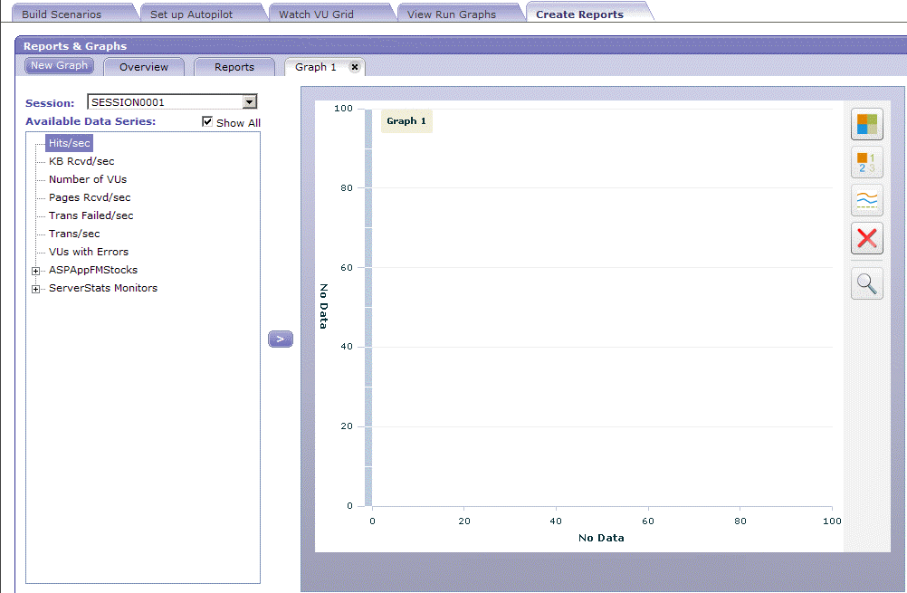

  1. Select the Create Reports tab.
  2. The Graph 1 tab is displayed with a blank graph. Select Session0001 from the Session list. The data categories appear in the Available Data Series list.
  3. Click Show All.
    Figure 4-30 Create Reports Tab
    Create Reports tab filters
    Description of "Figure 4-30 Create Reports Tab"
  4. Double-click Hits/sec, KB Rcvd/sec, Pages Rcvd/sec, and Trans/sec in the Available Data Series field to add the counters to the graph. These are the overall counters. You can also select them and click the Add Data Series button.
  5. Expand the ServerStats Monitors node then double-click the OLT Server (Processor: % Processor Time: 0) node to add it to the graph.

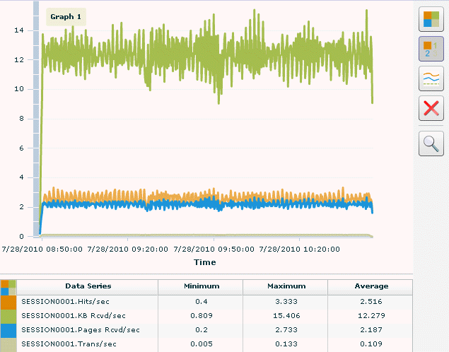

  6. Click the Show Legend button on the right side of the graph. The chart legend view opens over the graph.
    Figure 4-32 Sample Session Report Graph Showing the Legend View
    Description of Figure 4-32 follows
    Description of "Figure 4-32 Sample Session Report Graph Showing the Legend View"
    The legends show which color line represents which virtual user profile, script page, and Oracle Load Testing ServerStats counter. The legends for Oracle Load Testing data show the session, the virtual user profile, and the scripts page in the form session.profile.page[#]. The legends for ServerStats data show the session, counter object, counter instance and counter in the form session.object.instance.counter.
    You can export the graphs to .png and .jpg image files or the data to comma separated value files and Microsoft Excel files.
  7. Click on a data series once in the legend to hide the data series plot line in the graph. The data series will be dimmed in the legend.
  8. Click a hidden data series once in the legend to show the data series plot line in the graph.
  9. Click the Show Legend button again to hide the legend.
  10. Click the Show Chart Statistics button on the right side of the graph. The chart statistics table view opens at the bottom of the graph.
    Figure 4-33 Sample Session Report Graph Showing the Chart Statistics
    Description of Figure 4-33 follows
    Description of "Figure 4-33 Sample Session Report Graph Showing the Chart Statistics"
  11. Move the mouse cursor over a data series line in the graph. The data point information popup appears over the graph.
