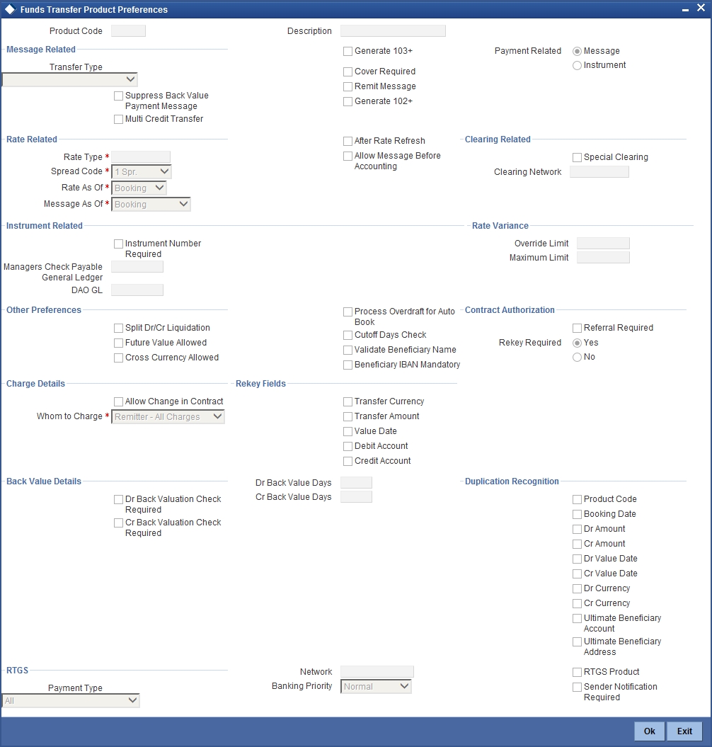

3.3 Preferences for Product
3.3.1 Specifying Preferences for Product
‘Preferences’ are the attributes or terms related to core processing that you define for a product. By default, a transfer involving a product inherits all the attributes defined for the product. However, some attributes (preferences) that are defined when the product was created can be changed during the processing of individual FT contracts (i.e., at the contract level) involving the product.
Click ‘Preferences’ button to invoke the FT Product Preferences screen. Through this screen you can define the following Preferences for a product:
The product code together with a brief description that you specified for the product in the product definition screen will be displayed at the top of the screen. The FT Product- Preferences screen contains nine sections. Each of these sections captures specific information about the product.

3.3.2 Specifying Message Related Details for Product
In this section you can define message related details for outgoing transfers.
Transfer Type
Indicate the type of transfers that the product can be associated with. From the option list you can choose any of the following options:
Note
The type of transfer that you indicate, will determine the type of payment message that will be generated for contracts involving the product.
Suppress BV Payment messages
Indicates whether or not the system should suppress by default, the payment message for all back valued contracts (contracts with debit value date less than the system date) of the product. This would be enabled only for outgoing funds transfers. By default, this option would be unchecked for all outgoing FT products.
For instance, if the bank wishes not to generate and send outgoing payment message for a back valued dated contracts, then the bank can check this option to enable the option.
Multi Credit Transfers
Enabling this option indicates that the particular FT product can be used for Multi Credit Transfers and also to generate MT201 message A Multi Credit Transfer may be either a Multi Customer Transfer or a Multi Financial Institution Transfer or Multi Transfer for Own Account. In case of a Multi Customer Transfer, the payment message sent will be MT102 not MT103. In case of a Multi Financial Institution Transfer, the payment message sent will be MT203. In case of a Multi Financial Transfer for Own Account, the payment message sent will be MT201. Multi Credit Transfer will be allowed in the following instances:
Cover Required
Indicates whether a cover message needs to be sent for the transfer or not. Check against ‘Cover Required’ to indicate that a cover is required. Leave it unchecked to indicate otherwise.
Generate 103+
Indicate whether MT 103 messages for outgoing transfers using the product must be generated in the MT 103+ format.
As a result of this maintenance, the system will generate payment messages in the MT 103 + format for all contracts involving the product.
Note
If you are enabling the MT 103+ option for a product, also ensure to enable the same op­tion for the branch, customer and currency involved in the transaction. The criteria for val­idation will be as follows:
If the validation criteria fail due to some reason the system displays an error message informing you about its inability to generate the payment message in the preferred MT 103 + format.
Generate MT102+
Check this box to indicate that MT 102+ messages can be processed for the Product code you are maintaining. On checking this box, you must also select Multi Customer Transfer so as to process MT102+ messages.
Remit Message
Check this field to send remit messages using this product. Also, If you wish to send the envelope contents, you need to check this field.
The following validations will be carried out in Oracle FLEXCUBE if the ‘Remit Message’ box is checked:
The remit message will be displayed in the message in the Block 119 as 119:REMIT.
Note
The ‘Remit Message’ box is enabled only for customer transfer.

3.3.4 Specifying Payment Related Preferences
For an FT product, you can specify the mode in which the payment processing would be put through, for contracts involving the product. The mode may differ based on the classification of the contract – whether incoming or outgoing, whether bank or customer, and so on.
Message
For instance, in an outgoing customer funds transfer, payment may be made (i.e., the transfer of funds can be effected) through SWIFT messages such as MT 103. To specify this, indicate the payment option as ‘Message’ type, in the Preferences screen.
Instrument
For manager’s check type of funds transfer product, the payment could be typically effected through a payment instrument. To specify this, indicate the payment option as ‘Instrument’, in the Preferences screen.
3.3.5 Specifying Rate Related Details for Product
In this section you can specify rate related details for the product. The rate details that you define for the product will be defaulted to all contracts involving this product. However, you have the option to change them for the contract.
Rate Type
Specify a valid exchange rate type that has to be applied to the transfer amount for contracts involving the product, from the adjoining option list.
If you choose 'Standard Rate', the system computes the transfer amount by picking up the exchange rates from the currency table maintained in the Core Services module of Oracle FLEXCUBE.
The system applies the spread that you define for the product to the standard exchange rate.

3.3.7 Specifying Clearing Related Details for Product
If you indicate the Payment Type as ‘Clearing’, you have to identify the Clearing Network. Further, if the FT product you are creating is used for processing ‘ZUS’ transactions, select the ‘Special Clearing’ option under Clearing Related information.
3.3.8 Specifying Instrument Related Details
In this section you can define Instrument related details for the product:
Instrument Number Required
Check against this option to indicate whether the Managers Check No should be a mandatory input at the Contract level. This would typically be applicable only for funds transfer product types such as Demand Drafts / Managers Check Issuance.
Managers Check Payable GL
If you have specified that an instrument number is required, you should also indicate the Managers check payable GL to be used by transfers involving the product. This GL would be used to park the outgoing funds till liquidation is done, whereby the amount in this GL would be washed out to the credit of the appropriate nostro account.
This field will be activated only if you had indicated that an Instrument Number is required. You can select a valid foreign and local currency type GL from the pick list that is available.
DAO GL
In the case of incoming transfers where the payment is routed to the ultimate beneficiary through a suspense GL (which is an intermediary parking account), you must specify the DAO GL number.
You can select a DAO GL from the option list that is available.
Note
The DAO GL is also credited when an Incoming FT is received, in case the credit account is closed or the account number mentioned is invalid.
3.3.9 Specifying Contract Authorization Details for Product
You can specify whether certain important details of the contract involving this product need to be re-keyed at the time when the contract is being authorized. If you indicate positively then the fields that you specify will have to be re-keyed at the time the contract is authorized.
Under ‘Fields’ you will have to check against the specific fields that need to be re-keyed during contract authorization.
This facility has been incorporated as a safety measure. It would do you well to indicate positively in these fields as the possibility of human error cannot be discounted. For instance let us assume that the value date has been input incorrectly for a contract. If you have specified 'Yes' at the Re-key Required field and checked on Value date under 'Rekey Fields' then at the time when the contact is being authorized this field will have to be re-keyed and the error which would have otherwise cost you dearly can be corrected.
3.3.10 Specifying Other Preferences for Product
Split Dr/Cr Liquidation
Check this option, then both initiation and liquidation events get triggered for any outgoing FT product. By default, this option is not enabled.
Future Value Allowed
Check this option if the future valued contracts can be input using this product
Cross Currency Allowed
Check this option if the Cross-currency transactions can be input using this product
Process Overdraft for Auto Book
Check this option if the Process overdraft for Autobook facility should be made available for the product. This field is applicable to future dated contracts involving this product. The Autobook function automatically liquidates future dated contracts. There could be a situation where a customer requests you transfer an amount that actually exceeds the amount in his account. In this field you can specify whether contracts involving this product which is picked up by the Autobook function can be processed in spite of the overdraft.
Validate Beneficiary Name
Check this option if the Beneficiary Name should be validated against the authorized variations of the customer’s name maintained in the Customer Names screen. This feature is applicable only for incoming funds transfers. If you enable this option, all incoming FTs involving the product are processed only after the customer’s Account Number and Name correspond to the authorized variations of the customer’s name.
Beneficiary IBAN mandatory
You can indicate whether IBAN validation needs to be done in respect of the Beneficiary account number of the contract. If the IBAN validation fails, an error message is displayed by the System.
The following details can be specified:

3.3.14 Applying Currency Cut-off Checks on Transactions Involving Product
You can choose to restrict the time within which (or before which) funds transfer transactions involving a customer, in the product, involving a specific currency, must be received for processing. For a specific customer, product, and a currency, you can specify a certain number of days before which a transaction involving the combination must be received, as well as a cut-off time before which transactions must be received. These parameters are known as currency cut-off parameters, and you maintain these parameters in the Value Dated Spread maintenance. You also maintain cut-off parameters to be applied for each currency, in the Currency Definition.
To specify that such cut-off checks must be performed in respect of a funds transfer transaction, select the option ‘Cut-off Days Check’ in the ‘Product Preferences’ screen. The cut-off days and the cut-off time that is to be applicable, for each currency, is picked up from the Value Dated Spread maintenance, if available, and if not, from the Currency Definition specifications.
3.3.15 Specifying Rate Variance
For an FT product you can specify the Rate type to be either Standard, Standard (after rate refresh). These values will be defaulted to all contracts involving this product. At the time you input a contract you have the option of changing the default and specifying an exchange rate of your choice. This field is applicable only if you have decided to change the product default and if the contracts linked to the product are cross currency transfers.
In this section you can specify the minimum and maximum limit by which the exchange rate you input for contracts involving this product can exceed the standard exchange rate.
3.3.15.1 Specifying Charge Details

3.3.16 Specifying Back Value Date Preferences for Funds Transfer Transac­tions
You can post back value dated transactions in Oracle FLEXCUBE. However, for the purpose of risk tracking, you can specify a limit beyond which users will be prevented from posting a back value dated transaction in the system.
3.3.16.1 Specifying Dr Back Value Days
This is the number of days within which a user will be allowed to post a back value dated debit funds transfer transaction. In other words, for a back value dated FT, the date on which the remitter’s account is to be debited, should fall within the limit maintained here.
3.3.16.2 Specifying Cr Back Value Days
Likewise, for a back value dated FT, the date on which the beneficiary’s account is to be credited, should fall within the limit maintained here.
If the value dates do not fall within the Debit or Credit Back Value Days maintained, the system will display the message as ‘The Debit or Credit value date is earlier than the Permitted value days’.
These validations are also carried out for transactions that are uploaded from external systems.
Note
You will be allowed to specify the ‘Dr Back Value Days’ and ‘Cr Back Value Days’ only if the ‘Dr Back Valuation Check Required’ and ‘Cr Back Valuation Check Required’ options are enabled. If the options are not enabled, the system will allow you to post back-valued transactions up to any date in the past (no check will be done). Further, if the option is checked but you have not maintained the ‘Back Value Days’ (maintained as NULL), the system will interpret it to be ‘Zero’ days allowed (for back valued transactions).
3.3.16.3 Specifying RTGS Preferences for Product
You need to specify the following RTGS preferences:
RTGS Product
Click this box if the product is of RTGS type.
Note
This field is applicable only for outgoing and incoming transfers. It will not be enabled for internal type of transfers.
Sender Notification Required
Check this box to indicate whether a notification is to be sent to the sender from the PM on the status of the original payment message.
When this box is checked and the original payment message is settled in the PM, the sender will receive an incoming MT012 message and if the original payment message is rejected in the PM the sender will receive an incoming MT019 message.
Network
Specify the FIN Y – copy network if the product is intended for FIN – Y Copy message generation. FIN Y copy payments are mostly used for sending a copy of a message or parts thereof to a third party, for example a Central Bank.
Note
This field is enabled only for outgoing and incoming transfers and for RTGS type of prod­ucts. It will not be enabled for internal type of transfers.
Payment Type
Select the types of payment available in case of TARGET-2 FIN Y-Copy from the adjoining drop-down list. This list displays the following values:
By default, the payment type is shown as ‘All’.
For TARGET2 payments, an error will be displayed if the beneficiary bank is not consistent with the product level payment type (domestic, within EU or outside EU).
Banking Priority
Select the priority of the payment messages from the adjoining drop-down list. This list displays the following values:
The banking priority is chosen as ‘Normal’ by default. However, you can modify this value.
You will not be allowed to amend the RTGS preferences, after the product has been authorized once.
Note
The Priority will be displayed in the RTGS messages in tag 113 as 4 Alphabets. For ex­ample, 113:NNNN – For a Normal Priority.
Duplication Recognition
You can specify the following details related to duplication check for transactions. The duplication check is carried out based on the combination of the preferences maintained at the FT product level.
Product Code
Check this box to indicate that the product code needs to be considered while checking for duplicate transactions.
Booking Date
Check this box to indicate that the booking date needs to be considered while checking for duplicate transactions.
Dr Amount
Check this box to indicate that the Dr amount needs to be considered while checking for duplicate transactions.
Cr Amount
Check this box to indicate that the Cr amount needs to be considered while checking for duplicate transactions.
Dr Value Date
Check this box to indicate that the Dr value date needs to be considered while checking for duplicate transactions.
Cr Value Date
Check this box to indicate that the credit value date needs to be considered while checking for duplicate transactions.
Ultimate Beneficiary Account
Check this box to indicate that the ultimate beneficiary account details need to be considered while checking for duplicate transactions.
Ultimate Beneficiary Address
Check this box to indicate that the ultimate beneficiary address details need to be considered while checking for duplicate transactions.
Note
If the field ‘Ultimate beneficiary Account’ is checked, the system checks for duplication and the following logic is applied:
Dr Currency
Check this box to indicate that the Dr currency needs to be considered while checking for duplicate transactions.
Cr Currency
Check this box to indicate that the Cr currency needs to be considered while checking for duplicate transactions.
The check for duplicate transactions is carried out based on the duplication check days maintained at Branch Parameter level. An override message gets displayed if any duplicate transaction is encountered.
Note
If none of the above checkboxes are selected, duplication check will not be performed, even if duplication check details have been specified at branch parameter level.
For more details on the duplication check preferences maintained at branch level, refer the section titled ‘Maintaining Duplication Check Details’ in Core Services user manual.
