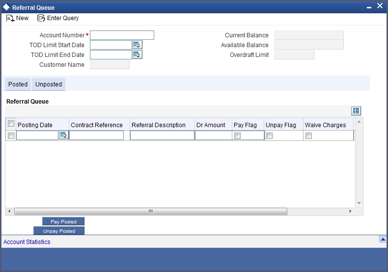

6.4.2 Invoking Referral Queue Function
From the application browser, choose Function Inputs under EOC operations. Maintain the Referral batch CSREFQPR for the respective branch and EOC group under Transaction Input.
Thereafter, from the application browser, select the Intra Day Batch from EOC Operations. Select the referral batch (CSREFQPR) from the LOV Function ID and run the batch.
6.4.3 Processing Contract with Referral Queue Function
When a FT contract is booked with the product which is checked as “Referral required”, for the customer whom the “Referral required” is checked and of the account class where “Referral required” is checked, then the same transaction is booked with the status as active and only the BOOK event fired.
However during the EOD process, the FTAUTO, BOD batch picks up all the transactions marked for referral and puts them under “Unposted” in the referral queue.
From the Application browser, select Customer accounts and under that Customer accounts Maintenance. Select Function ID STDREFQU (Referral Queue) to view all the transactions which have been updated by the batch process as Unposted. The same can be viewed each customer account wise.
Once the BOD process is completed, then you have to manually unlock the record customer wise and select each transaction as Pay flag / Unpay Flag. When you select the transaction as Pay Flag, it means you have accepted that transaction and the over draft facility can be used. However in case you select the Unpay flag for the transaction, then the transaction is rejected. Once this is done you have to save the record.
Note
The fields Pay Posted and Unpay Posted field can be used to do bulk postings.
Once the record is saved, the intraday batch CSREFQPR should be run. This batch processes all the contracts where the Pay Flag has been checked. INIT is fired for all the selected transactions. It also rejects all the contracts where the ‘Unpay’ field has been checked.
On unpay, the transaction will be reversed.
