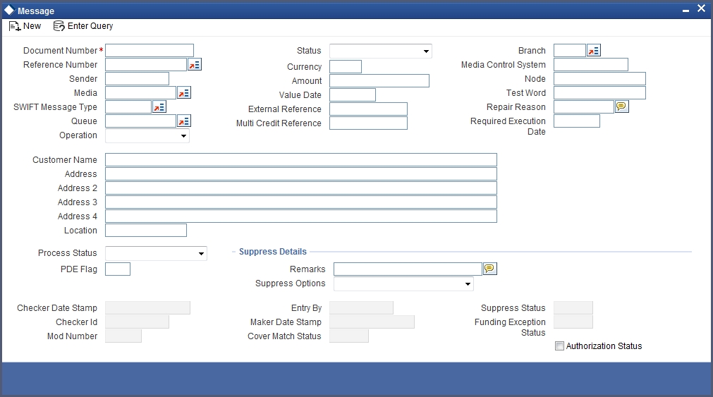

10.2 Incoming Message Browser
Incoming SWIFT messages containing details of funds transfer contracts are stored in the incoming directory that you have designated for receiving messages through SWIFT. The incoming browser is therefore the repository of all incoming messages in Oracle FLEXCUBE.
At this stage, the details of the funds transfer contract are not extracted, and the fields in the message that pertain to the funds transfer contract are not yet resolved.
For more information on the structure of the Incoming Browser and the operations that can be performed on the Incoming Message Browser, consult the Messaging system user manual.
As mentioned earlier, the end user queues and the access rights to the users in the department who will need to view the messages should already have been defined for your branch.

10.9.2 Suppression of Incoming SWIFT Payment Messages
You can choose to suppress an Incoming SWIFT Payment Message with the following statuses:
All Incoming SWIFT Messages are displayed in the Incoming Message Browser. To suppress a message, click ‘Suppress’ button in the Incoming Browser. The ‘Suppress Message’ screen is displayed.
The following options are available to suppress a Payment Message:
Specifying the ‘Suppress Message Generation’ option
If you select this option, Oracle FLEXCUBE will stop the generation of the Payment Message. However, the system will post the necessary accounting entries for the messages being suppressed.
Indicating the ‘Suppress Full’ option
If you select the full suppress option for a message, the system will not post the related accounting entries. Advice generation will also be stopped. In other words, the system will not pick up the Payment Message for any further processing.
Specifying the ‘No Suppress’ option
A message marked with the ‘No Suppress’ option will be processed like any other normal Incoming SWIFT Payment Message.
Specifying the remarks for a suppressed message
You can specify the reason for suppressing a Payment Message in the ‘Remarks’ field.
Click ‘Ok’ button to save the details and return to the Incoming Message Browser.
Authorizing Suppressed Message
A different user with appropriate rights will be required to authorize the suppressed Payment Messages. The system will display an appropriate warning message to the authorizer indicating that the Payment Message has been suppressed.
The system will maintain a detailed audit trail along with the suppression remarks for all Incoming SWIFT Payment Messages that have been suppressed.
Note
You will not be allowed to suppress Incoming SWIFT Payment Messages that have al­ready been processed by the system.

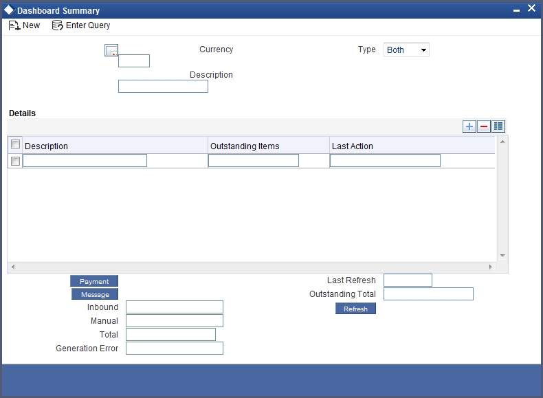

10.11 Payments Summary Dash Board
To view a summary of funds transfer transactions that has been sorted according to status queues, you can also use the Payments Dash Board screen. You can invoke the ‘Dash Board Summary’ screen by typing ‘FTDDSHBD’ in the field at the top right corner of the Application tool bar and clicking the adjoining arrow button.
In this screen, the following details are displayed for each type of queue:
Currency
You can choose to view the transaction queues summary for any transaction currency, or for all currencies.
Type
To view transaction status queues for manually entered funds transfers, chose ‘Manual’ in the ‘Manual/STP’ field. To view transaction status queues for funds transfers uploaded through the STP function, chose ‘STP’ in the ‘Manual/STP’ field. To view both types, choose ‘Both’. When you choose, all transaction queues pertaining to the type selected are displayed on the screen.
Viewing Transaction Summaries
To view the transaction summary for each transaction queue for STP transactions, click ‘Message’ button. The Incoming Browser is displayed.
Refreshing the Dash Board Information
You can refresh the information displayed in the Dash Board by clicking the ‘Refresh’ button in the Dash Board screen.

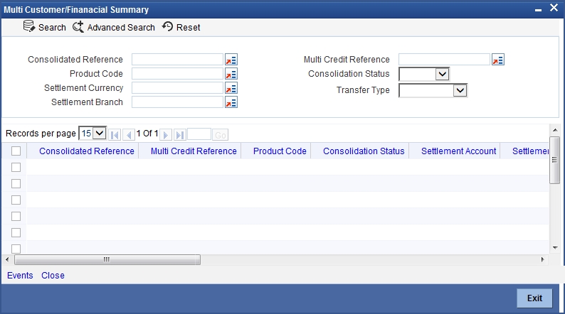

10.17 Viewing Funds Transfer Multi Customer Summary
You can generate a consolidated message for all the funds transfer transactions grouped under a consolidated reference maintained in the system using ‘Funds Transfer Multi Customer‘ screen. You can invoke the ‘Funds Transfer Multi Customer Summary’ screen by typing ‘FTSTCONS’ in the field at the top right corner of the Application tool bar and clicking the adjoining arrow button.
Here you can query on records based on the following criteria:
