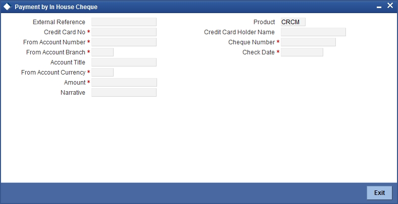

11.2 Processing Payments by In-House Bank Cheques
Oracle FLEXCUBE provides a facility to handle Credit Card payments by cheques issued by the bank. You can maintain these details using ‘Credit Card Payment By In-House Cheque’ screen. You can invoke this screen by typing ‘CRCM’ in the field at the top right corner of the Application tool bar and clicking on the adjoining arrow button.
You can maintain the following details here:
External Reference Number
Unique reference number is defaulted based on the branch.
Product
Retail teller product is defaulted as CRCM.
Credit Card No
Specify a valid Credit Card number from the adjoining option list.
Credit Card Holder Name
Name of the Credit Card holder is defaulted here.
From Account Branch
Branch code of the recovery account is defaulted here. However; you can specify branch code from the adjoining option list, if needed.
From Account Number
Recovery account number is defaulted here. However; you can specify account number from the adjoining option list, if needed.Account Title
Title of the recovery account is defaulted here.
From Account Currency
Currency of the account is defaulted, when account number is selected.
Cheque Number
Specify a valid cheque number for payment.
Note
Oracle FLEXCUBE validates for the availability and status of the cheque and also for the stop payment on the cheque.
Check Date
Current system date is defaulted as the check date.
Cheque Issue Date
Specify the issue date on the cheque from the adjoining calendar.
Note
If the difference between the ‘Cheque Issue Date’ and the ‘Cheque Date’ is greater than the ‘Cheque Stale Days’ maintained at the ‘Branch Parameters Maintenance’ screen, an error message stating that the cheque is a stale one will be displayed. However, stale cheque validation would not be done if the field ‘Cheque Stale days’ is not maintained at the ‘Branch Parameters Maintenance’ screen.
Amount
Specify the payment amount for credit card transaction.
Note
Amount currency can be FCY
Narrative
Specify remarks for the credit card payments, if any.
Click ‘Save’ icon to go to the next stage.

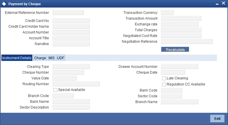

11.3 Processing Payments by Other Bank Cheques
Oracle FLEXCUBE provides a facility to handle Credit Card payments by cheques issued by other banks. You can maintain these details using ‘Credit Card Payment By Cheque’ screen. You can invoke this screen by typing ‘CRCN’ in the field at the top right corner of the Application tool bar and clicking on the adjoining arrow button.
Account Branch
Specify branch code of the Credit Card from the adjoining option list.
Narrative
Transaction Currency
Currency of the transaction is defaulted here; however, you can modify if needed.
Transaction Amount
Specify amount of the cheque drawn.
Account Number
Specify the account number of the Credit Card to credit the account.during credit card payment. Alternatively, you can select the account number from the option list. The list displays all the valid account numbers maintained in the system.
If you do not specify the account number, during credit card payment, the system credits the GL maintained as part of Card Maintenance GL.
Clearing Type
Specify clearing type you need for the cheque drawn from the adjoining option list.
Credit Card No
Cheque Number
Note
Routing Number
Specify routing number you need for the cheque drawn from the adjoining option list
Drawer Account Number
Specify Account number on which the cheque is drawn.
Cheque Date
Cheque date is defaulted here.
Cheque Issue Date
Note
In the single stage flow, if there is an transaction level override or error during approval then the transaction will be moved to the pending queue. Without save action being initiated, the transaction will not be in pending queue.
On clicking Pickup button, the system populates the vales in all the callforms of the screen and clicking pickup button is mandatory if you make any changes to the Transaction amount and exchange rate after first pickup.
Once you click ‘Pickup’ button once, then on amendment of xrate, amount, charge, pickup will be mandatory before save. On pick up, the fields that are currently enabled in the enrich stage will alone be retained as enabled fields.
Enrichment stage
On clicking save icon, the system validates and ensures for minimum mandatory data entry. If the data entry is correct, the system generates additional details maintained at different levels. The following screen will be displayed:
In addition to the details maintained in the previous stage, the system defaults the following details:
Recalculate
Click this button to recalculate charges for the cheque deposited.
For further processing details, refer ‘Depositing a Cheque’ section in ‘Instrument Transactions’ chapter of this User Manual.
After validating for the availability of the data, click ‘Save’ icon to go to the next stage.
Authorization Stage
On clicking save icon, the system validates and ensures for the correct entry of the data. If the data entry is correct, then the system moves the contract to Authorization Authority for authorization. Authorization Authority can approve or reject a transaction at this stage.
For authorization process details, refer ‘Depositing a Cheque’ section in ‘Instrument Transactions’ chapter of this User Manual.
After successful authorization, you can generate the transaction from task list and save. After saving the task, the system triggers clearing transaction and stores RT transaction reference number in XREF column of the Clearing Transaction for reference.

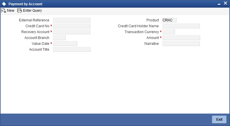

11.5 Processing Payments by Account
Oracle FLEXCUBE provides a facility to handle Credit Card payments by Account. You can maintain these details using ‘Credit Card Payment By Account’ screen. You can invoke this screen by typing ‘CRAP’ in the field at the top right corner of the Application tool bar and clicking on the adjoining arrow button.
Product
Retail teller product is defaulted as CRAC.
Credit Card No
Value Date
Current date of the system is defaulted here.
Specify currency in which cash is deposited for the specified credit card number, from the adjoining option list.
Recovery Account
Recovery account is defaulted here from the Credit Card number. However; you can specify a valid recovery account from the adjoining option list, if not defaulted.
To view the joint holder’s details of an account and the mode of operation maintained at the account level, place the cursor on the Recovery Account number field and press Ctrl+J. The system displays the ‘Joint Holder’ screen.
For more information on the ‘Joint Holder’ screen refer to the section ‘Joint Holder Maintenance’ in the Core User Manual.
Account Title
Account Branch
Branch code of the current branch is defaulted here. However; you can specify branch code from the adjoining option list, if needed.
Note
If account branch and transaction branch are different, then the system automatically pro­cesses inter-branch entries.
Amount
Note
If the payment is in FCY, then the system converts the amount based on the exchange rate code maintained at the ‘Product’ level
Narrative

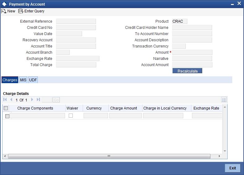

Enrichment stage
Exchange Rate
Exchange rate value is defaulted here to convert the transaction currency to account currency.
Recalculate
11.5.1 Charge Details Tab
Oracle FLEXCUBE defaults the charges maintained for the product and the customer group at ‘Arc Maintenance’ level. However; you can modify if needed and click on ‘Recalculate’ button to dsplay the final total amount for the transaction.
For further processing details, refer ‘Requesting for Funds Transfer’ section in ‘Cash Transactions’ chapter of this User Manual.

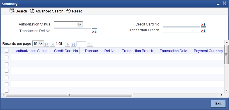

You can view a summary of Credit Card reversal payments maintained at the ‘Credit Card Payment Reversal’ level using ‘Credit Card payment Reversal Summary’ screen. You can invoke the ‘Credit Card payment Reversal Summary’ screen by typing ‘STSCCREV’ in the field at the top right corner of the Application tool bar and clicking the adjoining arrow button.
You can view records based on any or all of the following criteria:
Authorization Status
You can view records based on the authorization status of the Credit Card payment by selecting an option from the adjoining drop-down list. This list provides the following options:
Credit Card No
Select a valid Credit Card number to view records based on the Credit Card number, from the adjoining option list.
Transaction Ref No
Select a valid transaction reference number to view records based on the transaction reference number, from the adjoining option list.
Transaction Branch
Select a valid branch code if you need to view records based on the branch code, from the adjoining option list.
Click ‘Search’ button. The system identifies all records satisfying the specified criteria and displays the following details for each one of them:
