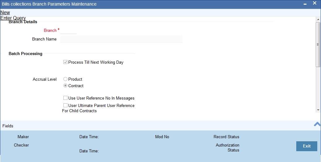

9.2.1 Maintaining Branch Parameters
A set of rules that governs the processing of bills in a particular branch of your bank is defined in the ‘Branch Parameters’ screen. This maintenance is common for both BC and Islamic BC modules.
You can invoke the ‘Bills & Collections Branch Parameter Maintenance’ screen by typing ‘BCDBRPRM’ in the field at the top right corner of the Application tool bar and clicking the adjoining arrow button.
The ‘Bills & Collections Branch Parameter Maintenance’ screen will be displayed.
9.2.2 Specifying the Branch Details
In this section specify the following details:
Branch
Select the branch code from the option list provided. You can maintain branch parameters only from the respective branches.
Note
At the head office level you can alter branch parameters of other branches also.
Description
When you select branch code from the option list, the description of the same is defaulted here.
9.2.3 Specifying Preferences for Batch Processing
The events, for which you had indicated automatic processing, are triggered off during the Batch Process. You can specify preferences for the automatic events that fall on a holiday in the Branch Parameters screen.
Process till Next Working Day
If you indicate that the processing has to be done up to the next working day - 1, all the automatic events falling due on the holiday will be processed by the batch process as part of the EOD.
The batch process should process automatic events falling due on a holiday, on either of the following dates:
If you indicate that processing has to be done only upto the System Date, then only the events scheduled for today (the last working day before the holiday) will be processed. The events of the holiday are processed by the batch process as part of the BOD process on the next working day.
Use User Reference No in Messages
If you wish to display the user reference number in the advices that are generated for a contract, select this option. All the advices generated at your branch will display the appropriate user reference number.
Note
You can specify a format for the generation of the User Reference Number in the ‘Se­quence Generation’ screen available in the Application Browser. Refer to the Core Servic­es User Manual for details on maintaining a sequence format.
Use Ultimate Parent User Reference for Child Contracts
If you wish to display the user reference number of the ultimate parent in the advices generated for child contracts, select this option. If this box is unchecked, the user reference number of the child is displayed for the child contracts.

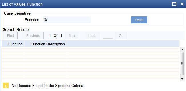

You can invoke the ‘Mandatory Batch Program Maintenance’ screen by typing ‘EIDMANPE’ in the field at the top right corner of the Application tool bar and clicking the adjoining arrow button.
You can enter the following details in this screen:
Module
Choose the module code from the adjoining option list.
Function Identification
Choose the function ID of batch that you wish to run. The adjoining option list displays all batch processes available for the module. Select the appropriate one.
