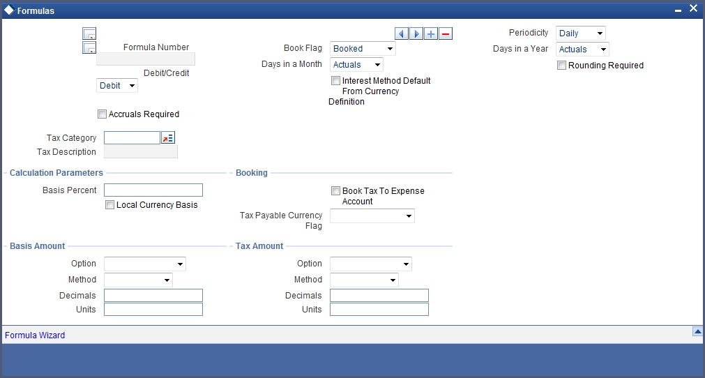

Click ‘Formulas’ button and invoke the ‘Formulas’ screen.
You need to maintain two booked and two tax formulae.
Formula 1
Specify the following details:
Book Flag
Select ‘Booked’ from the adjoining drop-down list.
Periodicity
Choose ‘Daily’ from the adjoining drop-down list.
Debit/Credit
Select ‘Debit’ from the adjoining drop-down list.
Days in a Month
Select ‘Actuals’ from the adjoining drop-down list.
Days in a Year
Select ‘365’ from the adjoining drop-down list.
Accrual Required
Check this box.
Rounding Required
Check this box.
Click ‘Formula Wizard’ button and invoke the ‘Formula Wizard’ screen.

Click ‘Formula Wizard’ button and invoke the ‘Formula Wizard’ screen. In this screen, you need to maintain the following expressions:

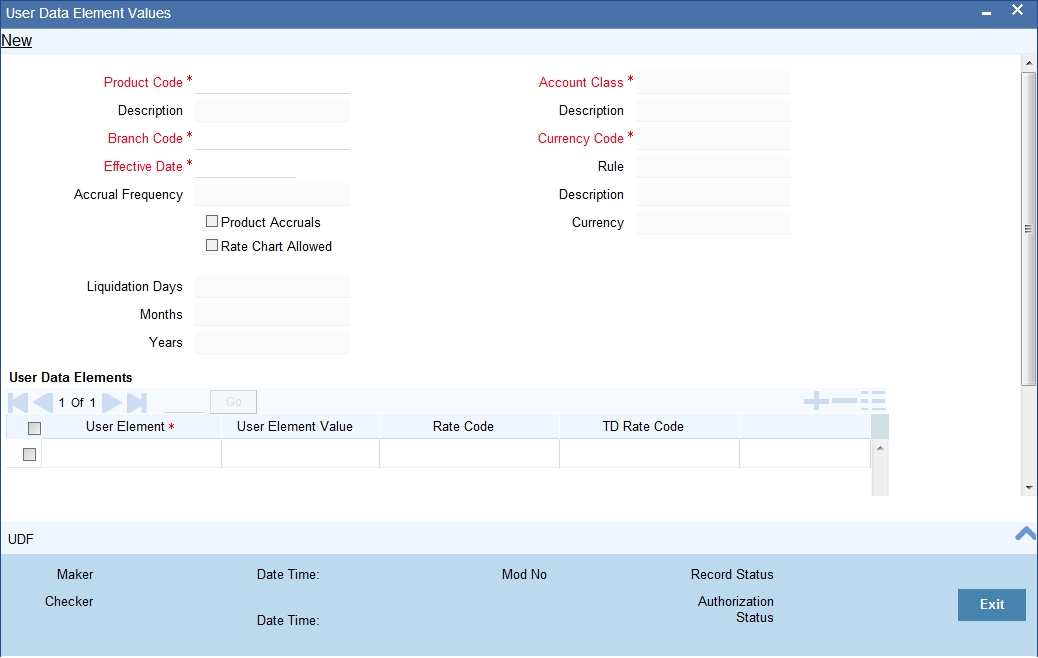

7.3 UDE Value Maintenance
You can maintain UDE values for the rules using the ‘Interest & Charges User Data Element Maintenance’ screen. You can invoke the ‘Interest & Charges User Data Element Maintenance’ screen by typing ‘ICDUDVAL’ in the field at the top right corner of the Application tool bar and clicking the adjoining arrow button.
For details about the screen, refer the chapter ‘Giving UDE Values for Condition’ in the Interest and Charges User Manual.
In this screen, you need to maintain the following UDEs for the different IC products. Assume that you have maintained the following IC products:
7.3.1 Interest on Term Deposit Payable Quarterly
You need to maintain values for the following UDEs under this product:
7.3.2 Interest on term deposit payable monthly
7.3.3 Interest on deposits for NRI customers
7.3.4 Recurring deposit interest product

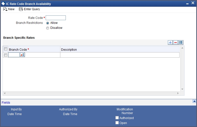

7.4 IC Rates Maintenance
You can maintain rate codes for branches using the ‘‘Interest & Charges Branch Availability Maintenance’ screen. You can invoke this screen by typing ‘ICDRESTR’ in the field at the top right corner of the Application tool bar and clicking the adjoining arrow button.
You need to maintain the following rate codes for all branches of your bank:

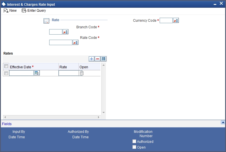

For the aforesaid rate codes, you need to maintain rates and effective dates in the ‘Interest and Charges Rate Input’ screen. You can invoke the ‘Interest and Charges Rate Input’ screen by typing ‘ICDRATES’ in the field at the top right corner of the Application tool bar and clicking the adjoining arrow button.
These rates are picked up by the TD module while processing interest applicable on a TD account.
Refer the chapter ‘Floating Rate Codes for IC Module’ for details about rate maintenance
