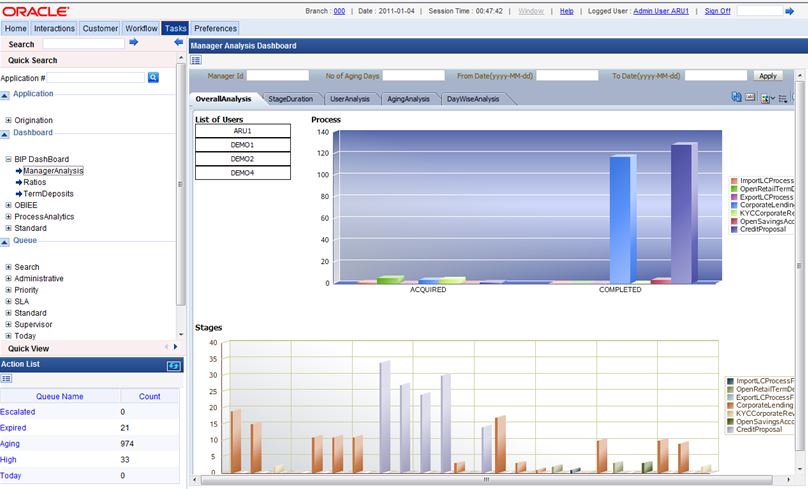

2.1 Landing Page
2.1.1 Tasks

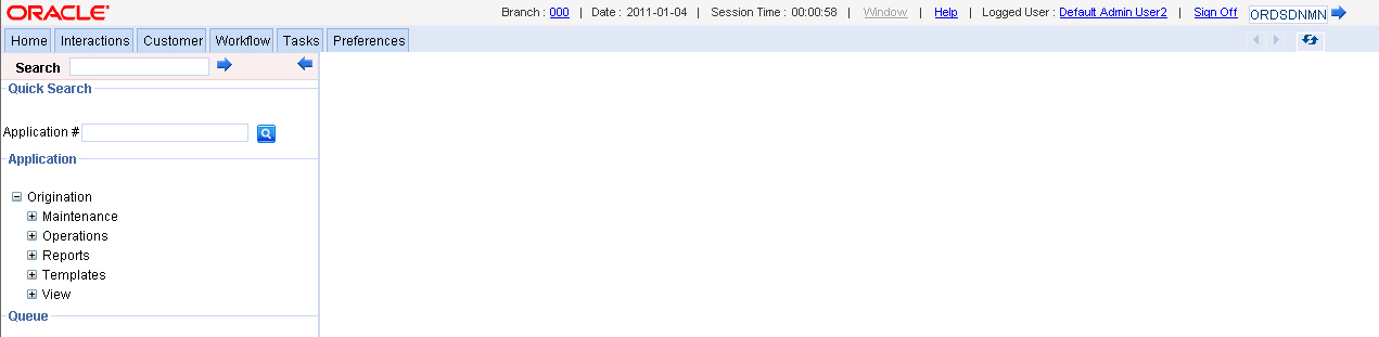

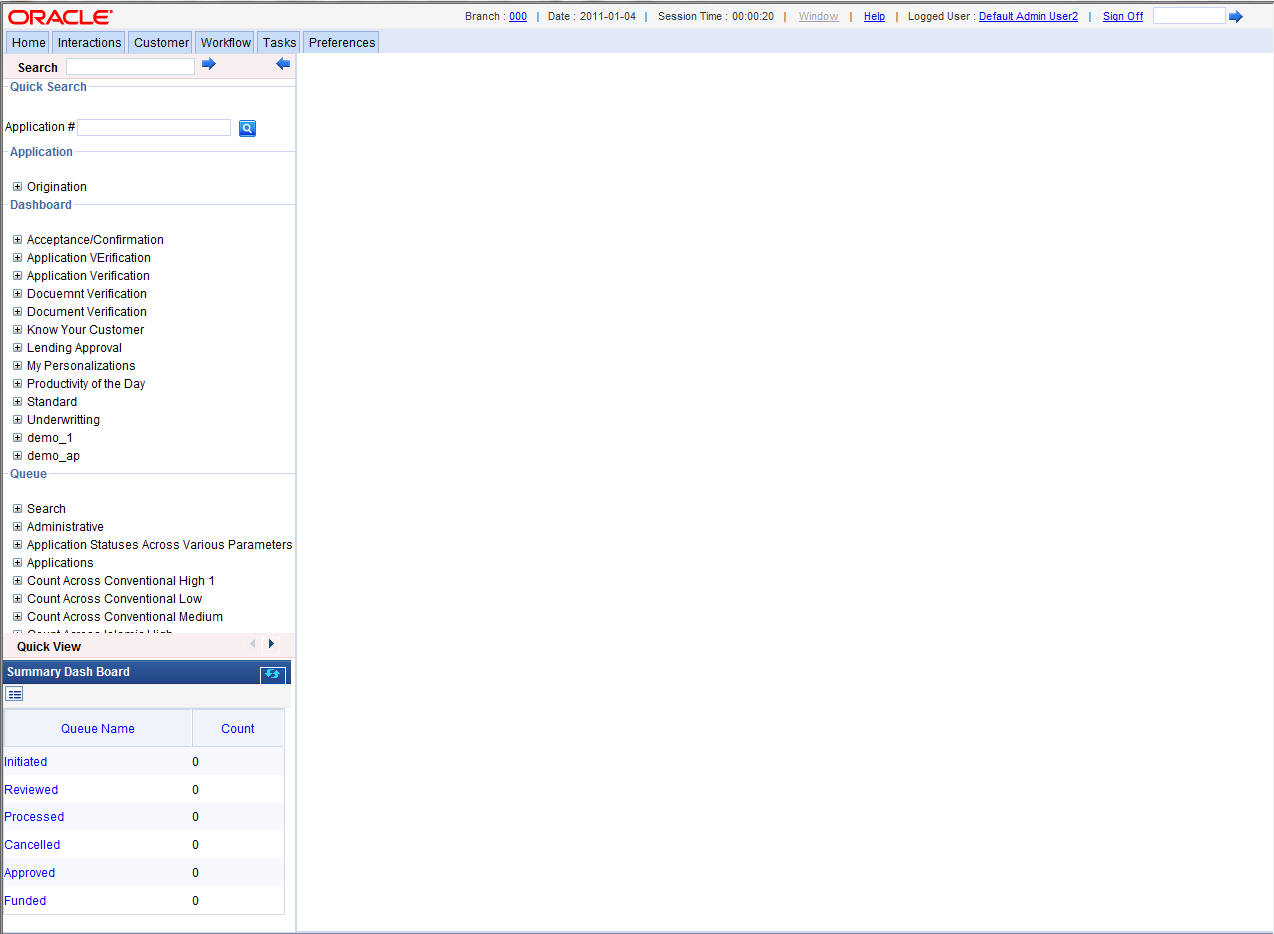

When you log into the application, the Landing Page, as shown below, is displayed:-
The following options are available to you in this screen:
Select ‘Tasks’ tab to view the tasks.
You have the following options under tasks:
2.1.2 Quick Search
If you know the application number, you can quickly search for an application using the quick search feature.
Specify the application number and click the adjoining search button. You can also specify a part of the application number. If the application number of any record has the number you have specified as a part of it, then the system will fetch that record.
Click any record to view the details.
2.1.3 Application
Under ‘Application’ section, you can view the menu to access the Oracle FLEXCUBE Origination screens.
You can expand the menu items and invoke the Origination screens.
2.1.4 Dashboard
Under ‘Dashboard’ section, you can view the list of the maintained and configured dashboards along with the default dashboards.
You can expand the menu items and invoke the dashboards.

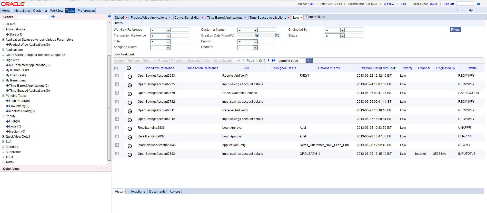

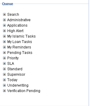

2.1.5 Queue
The ‘Queue’ menu displays the tasks under various queues. You can expand the menu and view the number of tasks under each queue.
If you select ‘Search’ and then click ‘All’, the ‘Task List - Search’ window will be displayed on the right hand side.
Here you need to input value for querying on the tasks. You can provide values for any or all of the following criteria:
Click ‘Search’ button to initiate the query. Based on the details specified, the system will display all tasks satisfying the search criteria.
If you select ‘Standard View’, the system will display the number of records available in each of the task queues viz. ‘Acquired’, ‘Assigned’, ‘Completed’, ‘Pending’ and ‘Supervisor’. Click the links to view the respective details in the right pane.
The Pending List displays tasks which are not yet acquired by anyone. On acquiring, the task goes to the Assigned List. From the Assigned List, you can capture the task and input the action. Then the transaction goes to Completed stage.
The following queues are available on this screen:

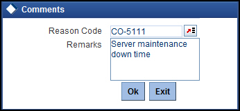

Escalate
System allows you to escalate a task to a supervisor or a higher authority. Follows are the types of escalations:
A task can be escalated only if it is acquired.

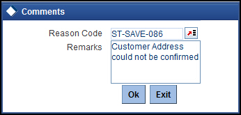

On clicking the ‘Escalate’ button, the system invokes the ‘Comments’ screen.
The system prompts to enter the following details:
Reason Code
Select the reason code from the adjoining option list. This list displays all valid reason codes maintained as ‘Common’.
Remarks
Specify the reason for escalation here.
On escalation, the task appears under the ‘Escalated’ option in the Supervisor queue. When the supervisor opens the escalated task, system displays the reason of escalation and remarks as an information message.
2.1.5.2 Opening Multiple Queues
You can open multiple queues as tabs and perform the required tasks in each queue.
Check the ‘Apply Filters’ box for a detailed search in a particular task in the queue. System displays the following tabs in each queue:

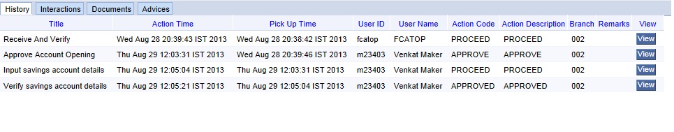

History
Under the ‘History’ tab, system displays the audit trail for the selected task.
Click the ‘View’ button to view the corresponding task screen.

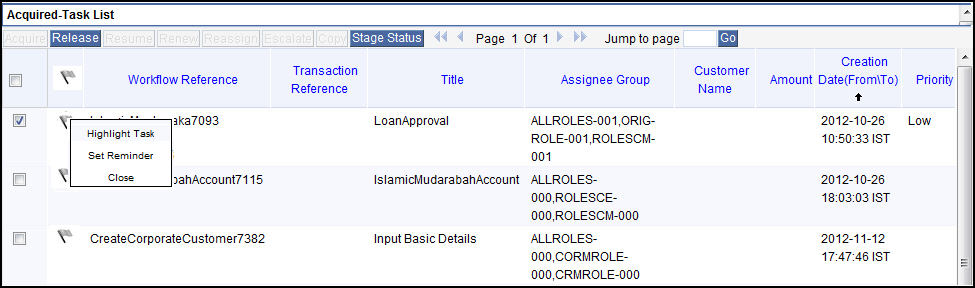

2.1.6 Scheduling Acquired Tasks
Oracle FLEXCUBE allows you to schedule you acquired tasks for a specific day/time based on your work structure, by setting reminders for the acquired tasks in your task list.
You can set a reminder by clicking the Reminder button for a task. System displays the following list of activities in the drop-down list:
In case a reminder has already been set for a task, on clicking the reminder flag, you will get the following options:
On setting a reminder, system sets the reminder flag for the task. Reminder flags are colour-coded to differentiate between time-spaced and time-barred tasks. When a task crosses the scheduled reminder date or time, the flag turns from green to red (tasks which that not cross the scheduled date or time will have green flags). At any point of time, you can view the reminder date, time and remarks, if any.
System allows you to set reminders for multiple tasks together. Select the tasks for which you want to set reminders and then select the appropriate option.

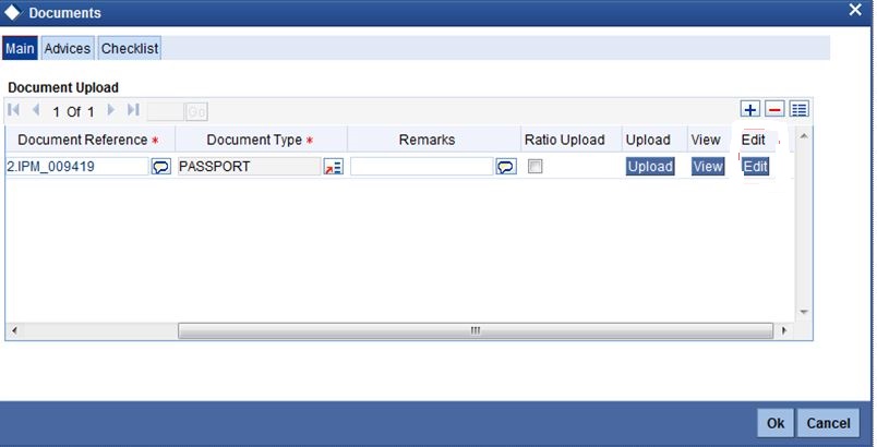

2.3 UCM Document Editor
You can upload and view the documents through the ‘Documents’ screen.
Main
Document Reference
Specify the document reference number.
Document Type
Select the type of document.The adjoining option list displays all the document types maintained in the system. Select the appropriate one.
Remarks
Specify remarks, if any.
Ratio Upload
Check this box if you require ratio upload.

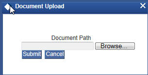

Upload
Click ‘Upload’ button to open the ‘Document Upload’ sub-screen. The ‘Document Upload’ sub-screen is displayed below
In the ‘Document Upload’ sub-screen, specify the corresponding document path and click the ‘Submit’ button. Once the document is uploaded through the upload button, the system displays the document reference number.
View
Click ‘View’ to view the document uploaded.

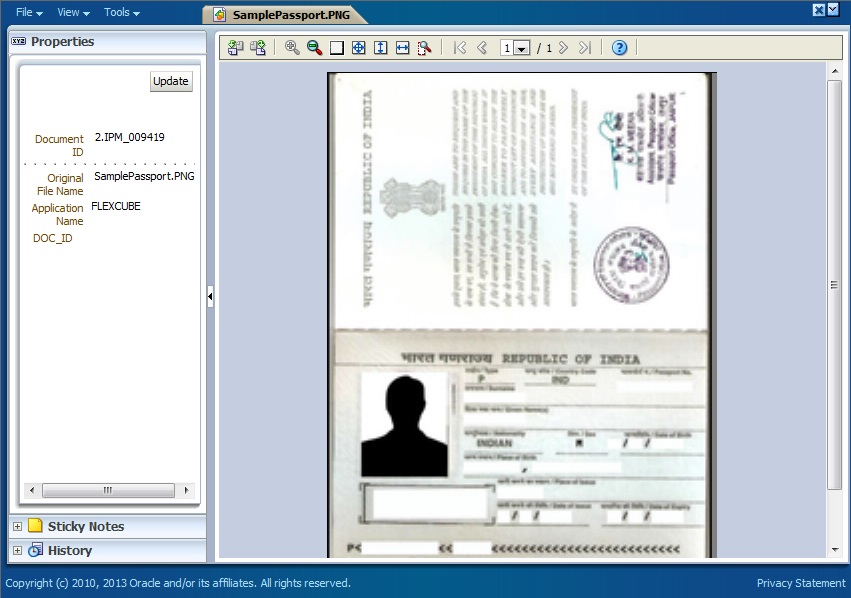

Edit
Using the ‘Edit’ button, you can edit the document details. When you click ‘Edit’ button, the system invokes a screen that displays the document and the properties
You can modify the document related information and click ‘Update’ button to update the changes. The system saves the changes made to the document.
Note
The changes made to the document using this Edit option will not be reverted even if you do not save the transaction. If you wish to revert the changes, you need to invoke the Doc­ument screen and manually modify it again.

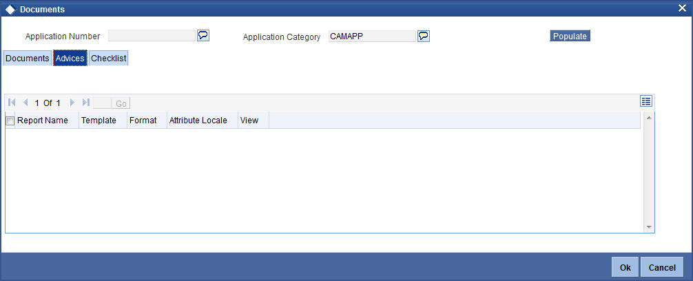

Advices
Click ‘Advices’ tab in Documents screen to view advice details.
Report Name
The system displays the report name.
Template
The system displays the template.
View
Click ‘View’ to view the document.

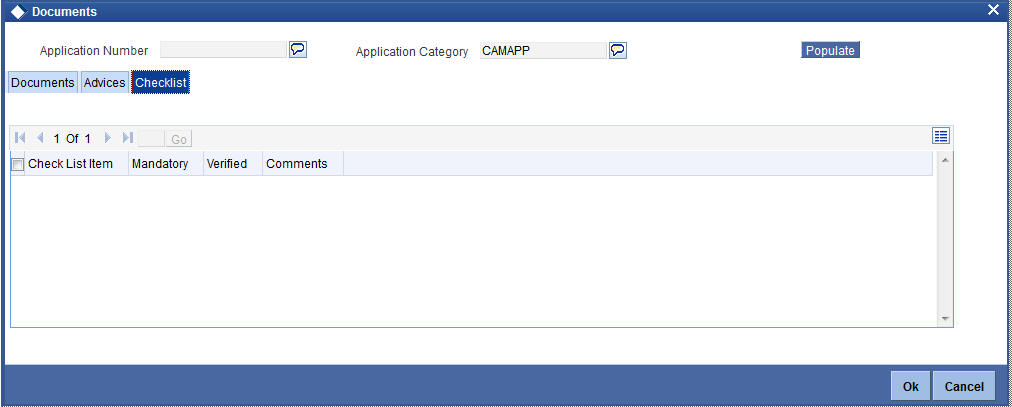

Checklist
Click ‘Checklist’ tab in Documents screen to view checklist details
Checklist Item
The system displays the checklist details.
Mandatory
This field is updated based on the maintenances in Documents sub screen.
Verified
Check this box to indicate whether the documents are verified.
Comments
Specify comments, if any.
