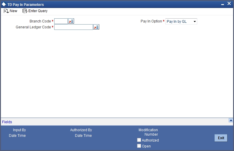

3.2 Pay-in Parameters
3.2.1 Maintaining Pay-in Parameters
In case you have specified that the TD Pay-in be done by GL, you need to maintain the GL details through the ‘Term Deposit Payin Parameters Maintenance’ screen. You can also invoke this screen by typing ‘STDTDPAY in the field at the top right corner of the Application tool bar and clicking the adjoining arrow button.
To link appropriate GLs in case the pay in option chosen is pay in by GL, you need to maintain the following details:
Branch Code
Specify the branch code for which you want to maintain payin parameters. The adjoining option list displays all valid branch codes maintained in the system. You can select the appropriate one.
Pay-in Option
Select the pay-in option from the adjoining drop down list. The options available are:
General Ledger Code
Specify the GL code that should be picked up the system for the TD pay in. The adjoining option list displays all valid GLs maintained in the system. You can select the appropriate one.

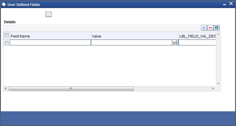

3.2.2 Specifying UDF Values
All User Defined Fields (UDFs) linked to the function ID ‘STDTDPAY’ are displayed in the ‘User Defined Fields’ screen. Invoke this screen by clicking ‘Fields’ button on the ‘Term Deposits Payin Parameters Maintenance’ screen.
Here you can specify values for each UDF.
Refer the User Manual titled ‘User Defined Field’ for details about defining UDFs.

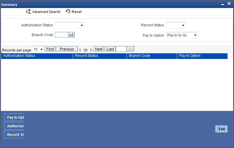

3.2.4 Viewing Pay-in Parameters Summary
You can view summary of all payin parameters using the ‘Term Deposit Payin Parameters Summary’ screen. To invoke this screen, type ‘STSTDPAY’ in the field at the top right corner of the Application tool bar and click the adjoining arrow button.
You can query on records based on any one or all of the following criteria:
Click ‘Search’ button. The system identifies all records satisfying the specified criteria and displays the following details for each one of them:
Double click on a record to invoke the detailed screen for that record.

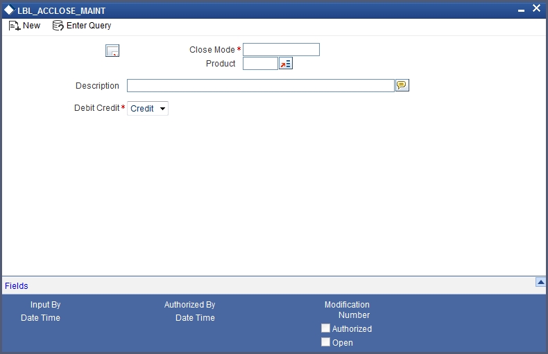

3.3.1 Maintaining Closing Mode
When you close an account the system checks whether any Interest/Charge (IC) products linked to the account are pending liquidation. If the account does not have any IC products pending liquidation the system will display list of ‘Close Out’ modes to facilitate account closure. You can maintain the closing modes using ‘Term Deposit Closing Mode Maintenance’ screen. To invoke this screen, type ‘STDCLOSE’ in the field at the top right corner of the Application tool bar and click the adjoining arrow button.
Specify the following details:
Closing Mode
You need to maintain the following modes:
Note
Description
Give a brief description for the closing mode.
Product
Specify the Retail Teller product that should be used for booking withdrawal entries. It can be any one of the following:
Debit Credit
The closure can be effected by means of a debit or a credit to the account. For each of the aforesaid closing modes, you need to select the ‘Debit’ option from the adjoining drop-down list..
3.3.2 Specifying UDF Values
All User Defined Fields (UDFs) linked to the function ID ‘STDCLOSE’ are displayed in the ‘User Defined Fields’ screen. Invoke this screen by clicking ‘Fields’ button on the ‘Term Deposit Closing Mode Maintenance’ screen.

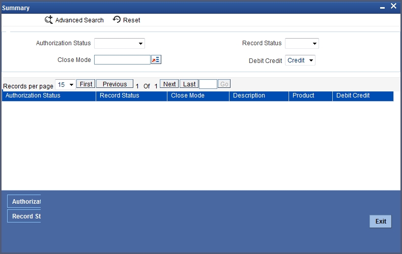

3.3.3 Viewing Closing Modes Summary
You can view summary of all closing modes using the ‘Term Deposit Closing Mode Maintenance’ screen. To invoke this screen, type ‘STSCLOSE’ in the field at the top right corner of the Application tool bar and click the adjoining arrow button.

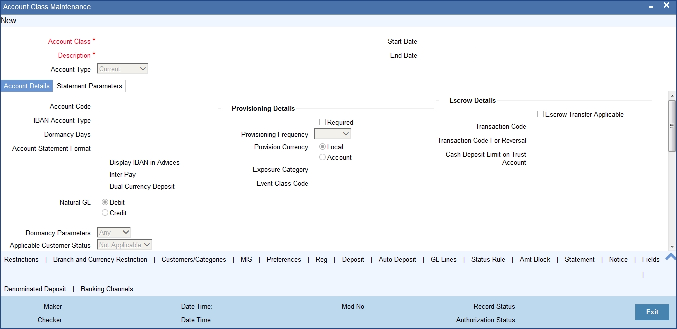

3.4.1 Maintaining Account Class for TD
To handle term deposits in Oracle FLEXCUBE, you have to set up an account class of type ‘Deposit’, in the ‘Account Class Maintenance’ screen. To invoke this screen, type ‘STDACCLS’ in the field at the top right corner of the Application tool bar and click the adjoining arrow button.
Account Class and Description
Identify the account class you are setting up with a unique code and a brief description.
Account Type
Select the ‘Deposit’ from the drop-down list.
Start Date
Specify the date from which the account class should become active, using the adjoining calendar. You will be able to create deposit accounts under this account class only from this date.
End Date
You can also specify the life span of the account class by indicating the end date.
The end date for an account class refers to the termination date after which, creation of new account under the account class is disallowed.
Consequently, the option list for Account Class in all further transactions screen in Oracle FLEXCUBE, will not display the ‘expired’ account class as of the system date. However, the existing accounts for the account class will be active even after the end date.
Note
If you do not specify an End Date for the account class, the account is taken to be an open-ended account class.
3.4.2 Account Details Tab
This tab is displayed by default on invoking the ‘Account Class Maintenance’ screen.
Account Code
As per your bank’s requirement you can choose to classify account classes into different account codes. The bank can decide the manner in which the account classes are to be assigned to different account codes. An account code can consist of a maximum of four characters. Depending on the customer account mask maintained, the value in the account code field would be used during the generation of customer account numbers through the ‘Customer Accounts Maintenance’ screen.
If you have decided to include account code as part of the customer account number (in the account number mask), then at the time of creating a new customer account number, you will need to select the account class for the account number being generated. In the option-list provided, the account class is displayed along with the associated account code. When the account number gets populated, it is the account code that forms a part of the customer account number.

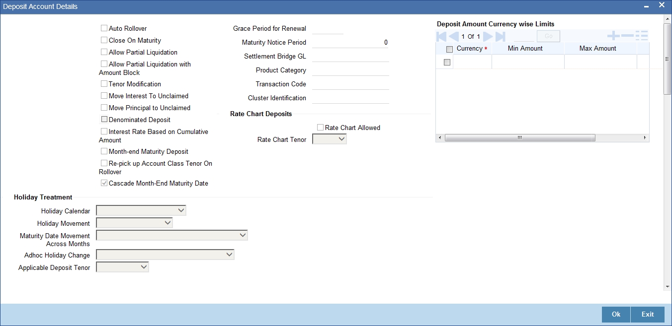

3.4.3 Maintaining Deposit Details
Click the ‘Deposits’ button to define the parameters for a deposit type account class. The ‘Deposit Account Details’ screen is displayed.
On the maturity date of a deposit, you can opt to:
The values given here will be defaulted when the TD is opened. You can modify defaulted values for each TD.
Auto Rollover
You can opt to automatically rollover a deposit if it is not liquidated on its maturity date. Check this box to automatically rollover deposits opened under the account class. TDs that are open and marked for Auto Rollover will automatically be rolled over during the Beginning of Day operations on the Maturity date. You can define the terms and conditions for the new deposit while maintaining the deposit account.
Close on Maturity
Deposit accounts opened under an account class can be closed automatically on the Maturity Date of the deposit. You can specify this for the account class you are maintaining by checking this box.
If you check this box, then during the Beginning of Day operations on the Maturity Date, the account will be closed. The principal will be moved, if specified, to the account your customer has directed. In case you don’t check this box and the deposit remains unclaimed, you can opt to move the principal and interest to the respective ‘Unclaimed GLs’ maintained at your bank.
Note
If you check the ‘Auto Rollover’ box, you will not be able to check ‘Close on Maturity’ box. Your specifications here will default to all deposit accounts opened under the account class. However, when maintaining a deposit account, you can change the specifications that default.

Rate Chart Allowed
Check this box to indicate that the system should calculate TD interest based on the LDMM float rate maintained in the ‘LD MM Floating Rate input’ screen (‘CFDFLTRI’), If you check this box, the system will pick interest rates based on different tenors, amount slab, currency and effective date for a TD. The rate is picked up at the time of booking. The rate is further picked up only at the time of liquidation/ rollover/ redemption operations based on re-population flag at IC product level.
You will not be able to modify this preference once the record is authorised.
Re-pick up Account Class Tenor On Rollover
Check this box to enable re-pick up of the account class tenor on rollover. If you check this box, the system will default the rollover tenor as 'Account Class Tenor'. During rollover, the system will pick up the default account class tenor.

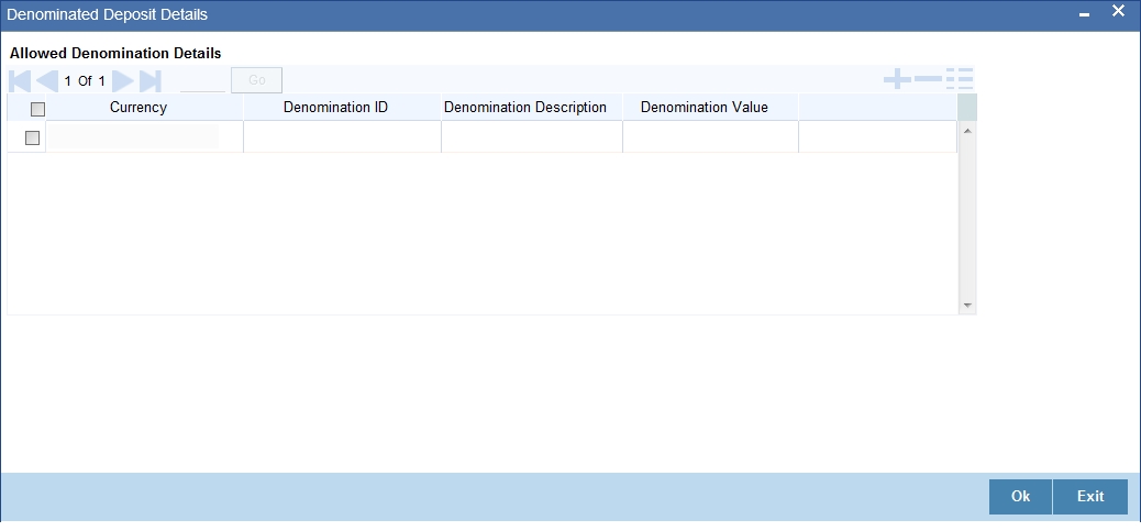

Denominated Deposit
Check this box to allow opening of denominated deposits. This box is automatically selected during save, if the Denomination details are maintained for the account class at the ‘Denominated Deposit Details’ Tab.

Grace Period for Renewal
Specify the grace period for renewing a TD. Only if grace days are provided, the TD can be renewed using the ‘Term Deposit Redemption’ screen (ICDREDMN) or ‘Renewal Simulation’ screen (ICDREDRN) upon maturity of the TD. This option is applicable only for deposits whose interest and principal is moved to unclaimed GLs upon maturity. If you check the ‘Auto Rollover’ box or the ‘Close on Maturity’ box, the system will ignore the value that you specify here. In other words, grace period will not be applicable on the maturity date in case of auto rollover or closure of the account.
After the account has matured, renewal of the TD is possible from the beginning of day (BOD) of the maturity date to the end of day (EOD) of the grace period. The TD gets renewed with the value date as of the maturity date when the grace period is valid.
The counter for the grace period is ‘0’ on the maturity date. It is incremented by 1 during EOD processing of every subsequent day. When the grace period counter is ‘0’, TD renewal is possible before start of the EOD as of the maturity date. When the grace period counter goes to ‘1’, TD renewal is possible before start of the EOD of the (maturity date +1),and so on.
Refer the section ‘Redeeming a TD’ and ‘Transferring to Unclaimed Deposit on Maturity’ in this User Manual for details about TD redemption and application of grace period respectively.
Grace period is maintained only at the account class level. You cannot modify it at account level.

Deposit Amount Currency wise Limits
Currency
Specify the Ccy for which the min / max / top-up units to be defined. The list displays all the active Ccy's maintained.
Min amount
Specify the minimum amount for which deposit should be created under this account class. If the TD account is booked below the minimum amount then the system displays an error message: "Deposit amount is less than the minimum amount at account class"
Max amount
Specify the maximum amount for which deposit can be created under this account class.The system will display a configurable override if the deposit amount contravenes the specified amount range or if the maximum amount is not specified.
Top-up Units
Specify the top-up units for each ccy. The top-up has to be made only in multiples of these units specified for each Ccy. if not, an error message "Top-up should be in multiples of top-up units" will be displayed on top-up.
Holiday Treatment
Holiday Calendar
Select the holiday calendar applicable to the account class from the adjoining drop-down list. This list displays the following values:
The holiday calendar is used to arrive at the maturity date. The holiday calendar defined at the account class is applicable to all term deposits under the account class. You cannot modify the ‘Holiday Calendar’ if there are active accounts under the account class.
For month-end deposits, if holiday calendar is applicable, then the account class holiday calendar options indicate the following:
Holiday Movement
Select the working day to which the holiday should be moved from the adjoining drop-down list. This list displays the following values:
Holiday movement is adjusting the next maturity date when the maturity date falls on a holiday, based on the Holiday Calendar chosen. 'Holiday Movement' is not applicable if you select 'Ignore' option for 'Holiday Calendar'.
Note
You cannot modify the 'Holiday Movement' if there are active account under the account class.
Maturity Date Movement Across Months
Select the maturity date movement across months from the adjoining drop-down list:
Maturity date across months is applicable only when the maturity date is adjusted to previous or next working day.
System displays an override message in the following cases:
Whenever there is a change in the maturity date, system changes the rollover maturity date accordingly.
System ignores the value of 'Maturity date movement across months' if you select the 'No Change' option for 'Holiday Movement'.
Adhoc Holiday Change
Select the adhoc holiday change from the adjoining drop-down list. The adjoining drop-down list displays the following values:
The adhoc holiday change is the change in branch and currency holiday calendar after opening the TD due to adhoc change in holiday or branch transfer of the deposit. System ignores the value of ‘Adhoc Holiday Change’ if you select the ‘Ignore’ option for ‘Holiday Calendar’.

3.4.4 Maintaining Denominated Deposit Details
You can maintain various denominations of the denominated certificates per currency using ‘Denominated Deposit Details’ screen. Only the denominations maintained in this screen can be used for issuance of denominated certificates under this account class.
To invoke this screen click the button ‘Denominated Deposits’ on the Account Class Maintenance’ screen.
The following details are captured here:
Currency
If inventory module is allowed, select a valid currency code for which the denomination ids are maintained in inventory module. If inventory module is not allowed then select any valid currency code maintained in the system.
Denomination ID
If inventory tracking is ‘YES”, then select the denomination id available at the inventory module. If inventory tracking is ‘NO’ then you can specify the required denomination id.
Denomination Description
Enter a description if inventory tracking is not available. If inventory tracking is done then the denomination description of the selected denomination id is defaulted here.
Denomination Value
Specify a denomination value if inventory tracking is not available. If inventory tracking is done then the denomination value of the selected denomination id is defaulted here. For further details about setting up an account class, refer the chapter ‘Maintaining Mandatory Information’ in the Core Entity User Manual.

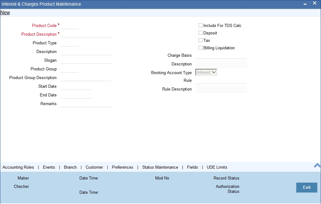

You need to set up an Interest/Charge product to handle the calculation of interest and charges on a TD. You can invoke the ‘Interest and Charges Product Maintenance’ screen by typing ‘ICDPRMNT’ in the field at the top right corner of the Application tool bar and clicking the adjoining arrow button.
Check 'Deposit' to create Deposit Interest product. The booking account type should be maintained as Interest for the deposit product. The accounting roles are generated for the product based on the interest rule maintained at ICDRUMNT.

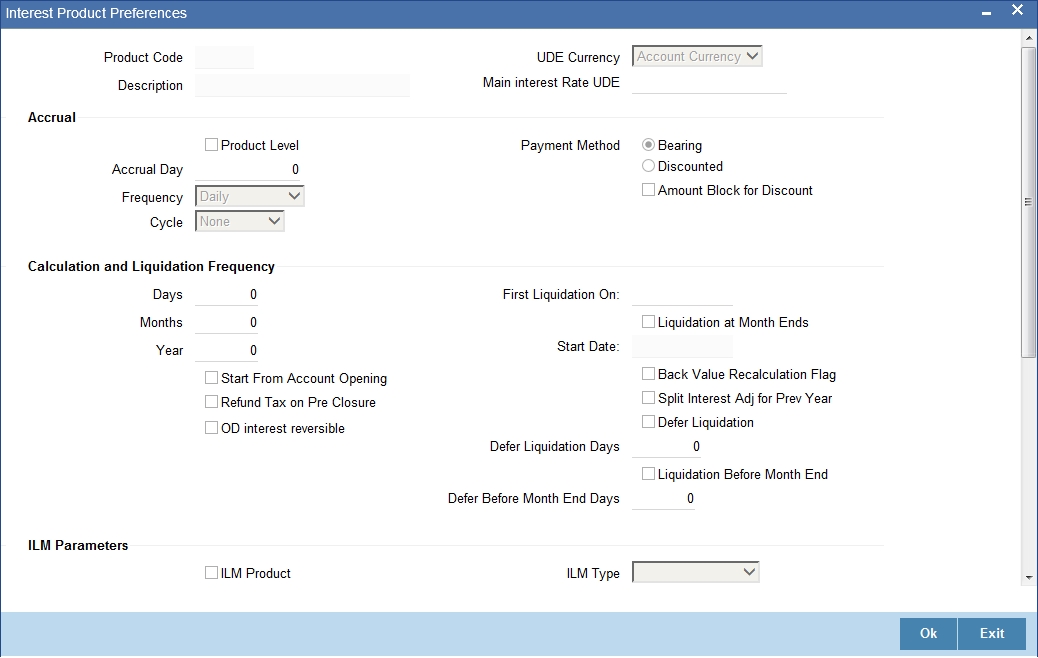

You can link the TD Account Class to the Interest product in the ‘Interest and Charges–Interest Product Preferences’ screen. Click ‘Preferences’ button on the ‘Interest and Charges Product Maintenance’ screen and invoke the following screen.
Here you can specify preferences for profit calculation and application on the accounts to which this product is applied.
Account Details
You can indicate the TD accounts on which this product should be applied.
Account Class
Specify the account class of ‘Deposit’ type that you have maintained for creating TDs. The adjoining option list displays all valid account classes maintained in the system. You can select the appropriate one.
All TDs created under this account class will inherit the interest parameters as maintained in this screen.
You should not link the same account class to multiple IC products. One deposit account class should be linked only to one interest product.
Currency
Specify the currency here. You can book deposit accounts in the currency and account class combination specified at the IC product level.
The system defaults the interest product to account at the time of booking if the account class with the currency combination is linked to the IC product.
Special Condition
Check this box to calculate interest. If Special Condition is checked, then the product is defaulted while booking the deposit account.
Note
While saving the IC product with Deposits checked, special condition is mandatory
Rate Change on Interest Liquidation.
If the box 'Rate Chart Allowed' has been checked for the account class, then you should leave this box unchecked. If this box is checked, then on every interest liquidation new rates are picked up for interest calculation. However, you cannot modify this box once authorized.
Rate Change onRollover
Check this box to re pick up the rate activity on the rollover of TD. The rate is picked up for fixed and rate chart allowed term deposits.
Open
Check this box if the account class and product combination is effective and open for booking deposit accounts. To discontinue the mapping of an account class on an IC product, uncheck this box.
Refer the chapter ‘Defining Interest and Charge Products’ in the Interest and Charges User Manual for details about setting up the product.
