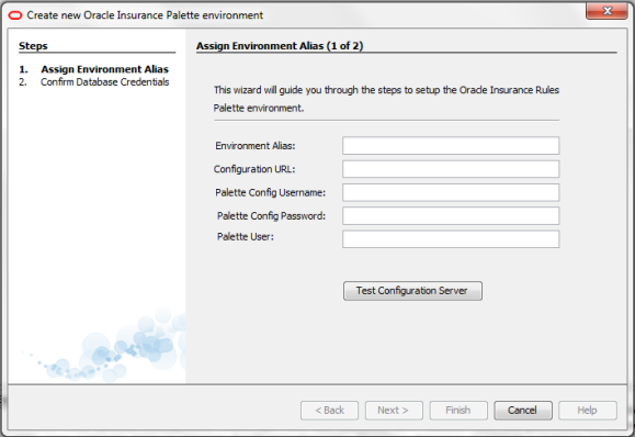

  4. The Assign Environment Alias screen (step 1 of the environment creation wizard) opens.
    Step 1 of the Environment Creation Wizard
  5. Enter an Environment Alias. This should be a descriptive name for the environment that will distinguish it from other environments.
  6. Enter the Configuration URL. This is the URL used to access the Web Application Utility.
    Example: http://rphost.yourdomain.com:9090/PaletteConfig
  7. Enter the Palette Config Username. This is a username used to log in to the Web Application Utility.
  8. Enter the Palette Config Password for the username used in the previous step.
  9. Enter the Palette User provided by the build manager which was created while configuring Palette Config fresh Environment.
    Note:The Palette Config credentials used do not have to be the credentials for an "administrator" user.
  10. Click Test Configuration Server to test the environment connection. If the connection is successful, click Next and advance to step 12.

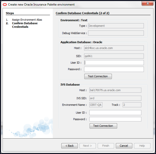

  11. The Confirm Database Credentials (2 of 2) screen opens(Step 2 of the Environment Creation Wizard).
  12. Type the User ID and password for the OIPA database.
  13. Type the User ID and password for the IVS database.
  14. Click Test Connection to test the connection. After both database connections are successful, click Finish.
