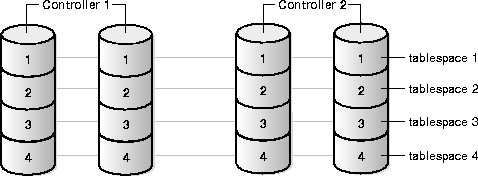

Striping Data
To avoid I/O bottlenecks during parallel processing, tablespaces accessed by parallel operations should be striped. As shown in Figure 26-2, tablespaces should always stripe over at least as many devices as CPUs; in this example, there are four CPUs. As was mentioned for partitioned granules, the number of disks over which you stripe these tablespaces should be at least equal to the value set for DOP.
Stripe tablespaces for tables, tablespaces for indexes, rollback segments, and temporary tablespaces. You must also spread the devices over controllers, I/O channels, and/or internal busses.
Figure 26-2 Striping Objects Over at Least as Many Devices as CPUs
To stripe data during loads, use the FILE= clause of parallel loader to load data from multiple load sessions into different files in the tablespace. To make striping effective, ensure that enough controllers and other I/O components are available to support the bandwidth of parallel data movement into and out of the striped tablespaces.
The operating system or volume manager can perform striping (OS striping), or you can perform striping manually for parallel operations.
We recommend using a large stripe size of at least 64KB with OS striping when possible. This approach always performs better than manual striping, especially in multi-user environments.

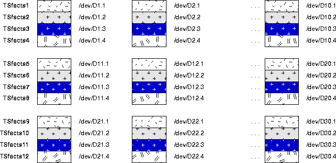

Manual Striping
You can use manual striping on all platforms. To do this, add multiple files to each tablespace, each on a separate disk. If you use manual striping correctly, your system will experience significant performance gains. However, you should be aware of several drawbacks that may adversely affect performance if you do not stripe correctly.
First, when using manual striping, the DOP is more a function of the number of disks than of the number of CPUs. This is because it is necessary to have one server process per datafile to drive all the disks and limit the risk of experiencing I/O bottlenecks. Also, manual striping is very sensitive to datafile size skew which can affect the scalability of parallel scan operations. Second, manual striping requires more planning and set up effort that operating system striping.

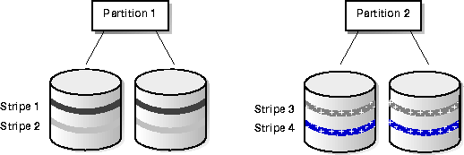

Local and Global Striping
Local striping, which applies only to partitioned tables and indexes, is a form of non-overlapping disk-to-partition striping. Each partition has its own set of disks and files, as illustrated in Table 26-3. There is no overlapping disk access, and no overlapping of files.
An advantage of local striping is that if one disk fails, it does not affect other partitions. Moreover, you still have some striping even if you have data in only one partition.
A disadvantage of local striping is that you need many more disks to implement it--each partition requires a few disks of its own. Another major disadvantage is that after partition pruning to only a single or a few partitions, the system will have limited I/O bandwidth. As a result, local striping is not very practical for parallel operations. For this reason, consider local striping only if your main concern is availability, and not parallel execution. A good compromise might be to use global striping associated with RAID5, which permits both performance and availability.

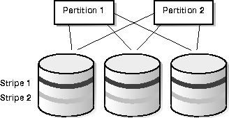

Global striping, illustrated in Figure 26-4, entails overlapping disks and partitions.
Figure 26-4 Global Striping
Global striping is advantageous if you have partition pruning and need to access data only in one partition. Spreading the data in that partition across many disks improves performance for parallel execution operations. A disadvantage of global striping is that if one disk fails, all partitions are affected.

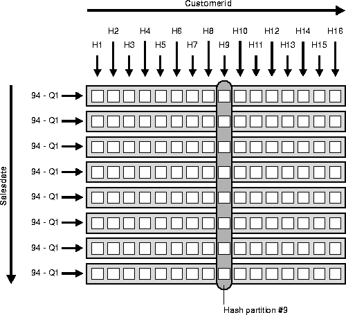

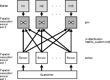

When you execute a full partition-wise join in parallel, the granule of parallelism, as described under "Types of Parallelism", is a partition. As a result, the degree of parallelism is limited to the number of partitions. For example, you should have at least 16 partitions to set the degree of parallelism of the query to 16.
You can use various partitioning methods to equi-partition both tables on the column customerid with 16 partitions. These methods are described in the following sub-sections.
Hash - Hash
This is the simplest method: the Customer and Sales tables are both partitioned by hash into 16 partitions, on s_customerid and c_customerid respectively. This partitioning method should enable full partition-wise join when the tables are joined on the customerid column.
In serial, this join is performed between a pair of matching hash partitions at a time: when one partition pair has been joined, the join of another partition pair begins. The join completes when the 16 partition pairs have been processed.
A pair of matching hash partitions is defined as one partition from each table with the same partition number. For example, with full partition wise joins we join partition 0 of sales with partition 0 of customer, partition 1 of sales with partition 1 of customer, and so on.
Parallel execution of a full partition-wise join is a straight-forward parallelization of the serial execution. Instead of joining one partition pair at a time, 16 partition pairs are joined in parallel by the 16 query servers. Figure 26-6 illustrates the parallel execution of a full partition-wise join.

Composite - Hash
This method is a variation of the hash/hash method. The sales table is a typical example of a table storing historical data. For all the reasons mentioned under the heading "Performance Considerations for Range Partitioning", a more logical partitioning method for sales is probably the range method, not the hash method.
For example, assume you want to partition the Sales table by range on the column s_saledate into 8 partitions. Also assume you have 2 years' of data and each partition represents a quarter. Instead of range partitioning you can use composite to enable a full partition-wise join while preserving the partitioning on s_saledate. Do this by partitioning the Sales table by range on s_saledate and then by subpartitioning each partition by hash on s_customerid using 16 subpartitions per partition, for a total of 128 subpartitions. The customer table can still use hash partitioning with 16 partitions.
With that new partitioning method, a full partition-wise join works similarly to the hash/hash method. The join is still divided into 16 smaller joins between hash partition pairs from both tables. The difference is that now each hash partition in the Sales table is composed of a set of 8 subpartitions, one from each range partition.
Figure 26-7 illustrates how the hash partitions are formed in the Sales table. In Figure 26-7, each cell represents a subpartition. Each row corresponds to one range partition for a total of 8 range partitions; each range partition has 16 subpartitions. Symmetrically, each column on the figure corresponds to one hash partition for a total of 16 hash partitions; each hash partition has 8 subpartitions. Note that hash partitions can be defined only if all partitions have the same number of subpartitions, in this case, 16.
Hash partitions in a composite table are implicit. However, Oracle does not record them in the data dictionary and you cannot manipulate them with DDL commands as you can range partitions.
Figure 26-7 Range and Hash Partitions of A Composite Table
This partitioning method is effective because it allows you to combine pruning (on s_salesdate) with a full partition-wise join (on customerid). In the previous example query, pruning is achieved by only scanning the subpartitions corresponding to Q3 of 1994, in other words, row number 3 on Figure 26-7. Oracle them joins these subpartitions with the customer table using a full partition-wise join.
All characteristics of the hash/hash method also apply to the composite/hash method. In particular for this example, these two points are common to both methods:

Partial Partition-wise Joins
Oracle can only perform partial partition-wise joins in parallel. Unlike full partition-wise joins, partial partition-wise joins require you to partition only one table on the join key, not both. The partitioned table is referred to as the 'reference' table. The other table may or may not be partitioned. Partial partition-wise joins are more common than full partition-wise join because it requires that you only partition one of the joined tables on the join key.
To execute a partial partition-wise join, Oracle dynamically re-partitions the other table based on the partitioning of the reference table. Once the other table is repartitioned, the execution is similar to a full partition-wise join.
The performance advantage that partial partition-wise joins have over conventional parallel joins is that the reference table is not 'moved' during the join operation. Conventional parallel joins require both input tables to be re-distributed on the join key. This re-distribution operation involves exchanging rows between query servers. This is a very CPU-intensive operation and can lead to excessive interconnect traffic in OPS environments. Partitioning large tables on a join key, either a foreign or primary key, prevents this re-distribution every time the table is joined on that key. Of course, if you choose a foreign key to partition the table, which is the most common scenario, select a foreign key that is involved in many queries.
To illustrate partial partition-wise joins, consider the previous Sales/Customer example. Assume that customer is not partitioned or partitioned on a column other than c_customerid. Because Sales is often joined with Customer on customerid and because this join dominates our application workload, partition Sales on
s_customerid to enable partial partition-wise join every time Customer and Sales are joined. As in full partition-wise join, we have several alternatives:
the simplest method to enable a partial partition-wise join is to partition Sales by hash on c_customerid. The number of partitions determines the maximum degree of parallelism because the partition is the smallest granule of parallelism for partial partition-wise join operations.
The parallel execution of a partial partition-wise join is illustrated in Figure 26-8 assuming that both the degree of parallelism and the number of partitions of Sales are 16. The execution involves two sets of query servers: one set, labeled 'set 1' on the figure, scans the customer table in parallel. The granule of parallelism for the scan operation is a range of blocks.
Rows from Customer that are selected by the first set, in this case this is all rows, are re-distributed to the second set of query servers by hashing customerid. For example, all rows in Customer that could have matching rows in partition H1 of Sales are sent to query server 1 in the second set. Rows received by the second set of query servers are joined with the rows from the corresponding partitions in Sales. For example, query server number 1 in the second set joins all Customer rows that it receives with partition H1 of Sales.
Figure 26-8 Partial Partition-wise Join

This section presents a case study illustrating how to create, load, index, and analyze a large data warehouse fact table with partitions in a typical star schema. This example uses SQL Loader to explicitly stripe data over 30 disks.
Figure 26-9 Datafile Layout for Parallel Load Example
Step 1: Create the Tablespaces and Add Datafiles in Parallel
Below is the command to create a tablespace named "Tsfacts1". Other tablespaces are created with analogous commands. On a 10-CPU machine, it should be possible to run all 12 CREATE TABLESPACE commands together. Alternatively, it might be better to run them in two batches of 6 (two from each of the three groups of disks).
Extent sizes in the STORAGE clause should be multiples of the multiblock read size, where:
blocksize * MULTIBLOCK_READ_COUNT = multiblock read size
INITIAL and NEXT should normally be set to the same value. In the case of parallel load, make the extent size large enough to keep the number of extents reasonable, and to avoid excessive overhead and serialization due to bottlenecks in the data dictionary. When PARALLEL=TRUE is used for parallel loader, the INITIAL extent is not used. In this case you can override the INITIAL extent size specified in the tablespace default storage clause with the value specified in the loader control file, for example, 64KB.
Tables or indexes can have an unlimited number of extents provided you have set the COMPATIBLE system parameter to match the current release number, and use the MAXEXTENTS keyword on the CREATE or ALTER command for the tablespace or object. In practice, however, a limit of 10,000 extents per object is reasonable. A table or index has an unlimited number of extents, so set the PERCENT_INCREASE parameter to zero to have extents of equal size.
It is not desirable to allocate extents faster than about 2 or 3 per minute. See "ST (Space Transaction) Enqueue for Sorts and Temporary Data" for more information. Thus, each process should get an extent that lasts for 3 to 5 minutes. Normally such an extent is at least 50MB for a large object. Too small an extent size incurs significant overhead and this affects performance and scalability of parallel operations. The largest possible extent size for a 4GB disk evenly divided into 4 partitions is 1GB. 100MB extents should perform well. Each partition will have 100 extents. You can then customize the default storage parameters for each object created in the tablespace, if needed.

In Case 3 (illustrated in the example), the DBA wants precise control over the load. To achieve this, the DBA must partition the input data in the same way as the datafiles are partitioned in Oracle.
This example uses 10 processes loading into 30 disks. To accomplish this, the DBA must split the input into 120 files beforehand. The 10 processes will load the first partition in parallel on the first 10 disks, then the second partition in parallel on the second 10 disks, and so on through the 12th partition. The DBA runs the following commands concurrently as background processes:
   SQLLDR DATA=jan95.file10.dat DIRECT=TRUE PARALLEL=TRUE FILE=/dev/D10.1
   SQLLDR DATA=dec95.file10.dat DIRECT=TRUE PARALLEL=TRUE FILE=/dev/D29.4

Using Local and Global Striping
Parallel DML works mostly on partitioned tables. It does not use asynchronous I/O and may generate a high number of random I/O requests during index maintenance of parallel UPDATE and DELETE operations. For local index maintenance, local striping is most efficient in reducing I/O contention, because one server process only goes to its own set of disks and disk controllers. Local striping also increases availability in the event of one disk failing.
For global index maintenance, (partitioned or non-partitioned), globally striping the index across many disks and disk controllers is the best way to distribute the number of I/Os.
If you have global indexes, a global index segment and global index blocks are shared by server processes of the same parallel DML statement. Even if the operations are not performed against the same row, the server processes may share the same index blocks. Each server transaction needs one transaction entry in the index block header before it can make changes to a block. Therefore, in the CREATE INDEX or ALTER INDEX statements, you should set INITRANS, the initial number of transactions allocated within each data block, to a large value, such as the maximum DOP against this index. Leave MAXTRANS, the maximum number of concurrent transactions that can update a data block, at its default value, which is the maximum your system can support. This value should not exceed 255.
If you run a DOP of 10 against a table with a global index, all 10 server processes might attempt to change the same global index block. For this reason you must set MAXTRANS to at least 10 so all server processes can make the change at the same time. If MAXTRANS is not large enough, the parallel DML operation fails.
