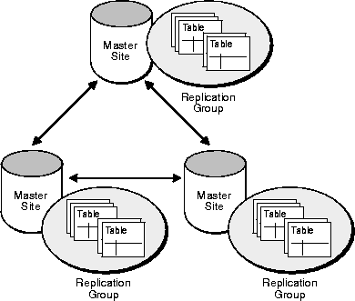

In a multimaster replication environment, the replication groups are called master groups. Corresponding master groups at different sites must contain the same set of replication objects (see "Replication Objects"). Figure 1-1 illustrates that master group "SCOTT_MG" contains an exact replica of the replicated objects at each master site.
Figure 1-1 Master Group SCOTT_MG contains same replication objects at all sites.

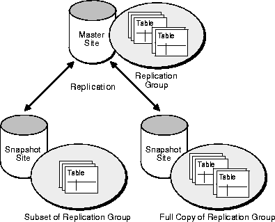

At a snapshot site, organization is maintained using a snapshot group. A snapshot group maintains a partial or complete copy of the objects at the target master group. Figure 1-2 illustrates that snapshot group "Group A" at the snapshot site maintains only a partial replica of master group "Group A" at the master site, while the "Group B" snapshot and master groups maintain a complete replica.
Additionally, Figure 1-2 illustrates that each site may contain multiple replication groups.
Figure 1-2 Snapshot Groups Correspond with Master Groups

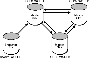

A replication group can exist at multiple replication sites. Replication environments support two basic types of sites: master sites and snapshot sites.
Figure 1-3 Three Master Sites and One Snapshot Site

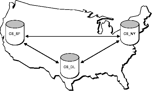

Failover Site
Multimaster replication can be useful to protect the availability of a mission critical database. For example, a multimaster replication environment can replicate all of the data in your database to establish a failover site should the primary site become unavailable due to system or network outages. In contrast with Oracle's standby database feature, such a failover site can also serve as a fully functional database to support application access when the primary site is concurrently operational.
Figure 1-4 Multimaster Replication System

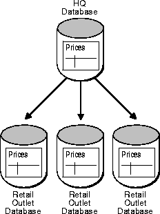

Information Distribution
Read-only snapshot replication is useful for information distribution. For example, consider the operations of a large consumer department store chain. In this case, it is critical to ensure that product price information is always available and relatively current and consistent at retail outlets. To achieve these goals, each retail store can have its own copy of product price data that it refreshes nightly from a primary price table.
Figure 1-9 Information Distribution

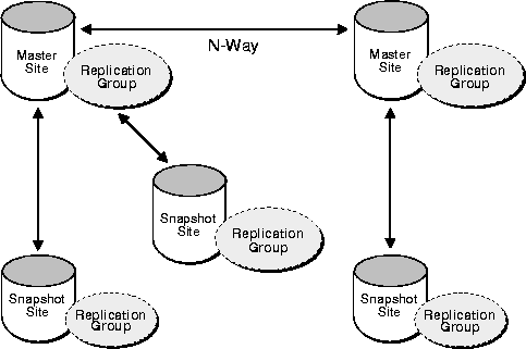

Multimaster replication and snapshots can be combined in hybrid or "mixed" configurations to meet different application requirements. Mixed configurations can have any number of master sites and multiple snapshot sites for each master.
For example, as shown in Figure 1-10, n-way (or multimaster) replication between two masters can support full-table replication between the databases that support two geographic regions. Snapshots can be defined on the masters to replicate full tables or table subsets to sites within each region.
Figure 1-10 Hybrid Configuration
