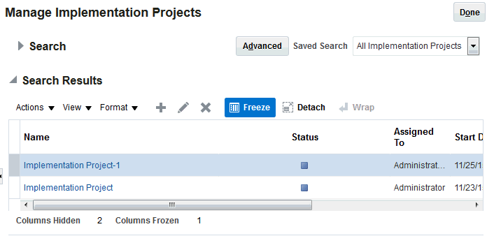

  1. In FSM, from the Tasks pane, select the Manage Implementation Projects link, and click the Implementation Plan that you created earlier.
    Description of GUID-BA92BB7A-B369-4759-A741-FFBCD2FDDE30-default.gif follows
