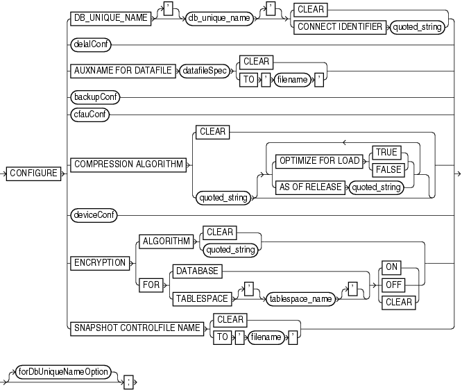

CONFIGURE
Purpose
Use the CONFIGURE command to create or change a persistent configuration affecting RMAN backup, restore, duplication, and maintenance jobs on a particular database. A configuration is in effect for any RMAN session on this database until the configuration is explicitly cleared or changed. You can use the SHOW command to display the configurations for one or more databases.

Semantics
configure
Syntax Element Description
DB_UNIQUE_NAME
db_unique_name
{CLEAR | CONNECT IDENTIFIER
'connect_string'}
Specifies the net service name for the physical standby database specified by DB_UNIQUE_NAME. The CONNECT IDENTIFIER string must not include the database user name and password.
RMAN must also be connected to the primary database as TARGET. RMAN must be connected to a recovery catalog.
When you run the RESYNC CATALOG FROM DB_UNIQUE_NAME command, databases in a Data Guard environment use the net service name to connect with the db_unique_name database. For example, assume that a standby database has the unique name standby1 and the net service name sby1. You connect RMAN as TARGET to the primary database and execute CONFIGURE DB_UNIQUE_NAME 'standby1' CONNECT IDENTIFIER 'sby1'. Every primary and standby database in the environment uses the net service name sby1 when it needs to make an Oracle Net connection to standby1.
Note: When the target database needs to connect to other standby or primary databases, it connects as the SYS user by using the existing Data Guard authentication mechanisms.
Suppose that you recently connected RMAN as TARGET to the primary database and used CONFIGURE ... FOR DB_UNIQUE_NAME standby_new to configure backup settings for standby database standby_new. However, you have not yet connected RMAN as TARGET to standby_new. In this case, you can execute RESYNC CATALOG FROM DB_UNIQUE_NAME standby_new. The primary database uses the connect identifier to make an Oracle Net connection to the standby database. When you later connect RMAN to the standby database, RMAN pushes the configuration from the recovery catalog to the mounted control file.
Note: If the database specified by CONFIGURE DB_UNIQUE_NAME is not registered in the recovery catalog, then RMAN implicitly registers it.
delalConf
Configures an archived redo log deletion policy.
AUXNAME FOR DATAFILE
datafileSpec TO 'filename'
Configures the auxiliary file name for the specified target data file to 'filename' (see Example 2-45). Specify CLEAR to unspecify the auxiliary file name.
If you are performing TSPITR or using DUPLICATE, then you can set AUXNAME to preconfigure the file names for use on the auxiliary database without manually specifying the auxiliary file names during the procedure. You cannot use CONFIGURE AUXNAME for recovery set, you must use SET NEWNAME.
For example, use this command during TSPITR if the data files are on raw disk and you must restore auxiliary data files to raw disk for performance reasons. Typically, you set the AUXNAME parameter in TSPITR for the data files of the SYSTEM and SYSAUX tablespaces and the tablespaces containing rollback or undo segments. Do not overlay files which are in use by the production database and can be discarded after TSPITR completes. In essence, the AUXNAME of a data file is the location where TSPITR can create a temporary copy of it.
When renaming files with the DUPLICATE command, CONFIGURE AUXNAME is an alternative to SET NEWNAME. The difference is that after you set the AUXNAME the first time, you do not need to reset the file name when you issue another DUPLICATE command: the AUXNAME setting remains in effect until you issue CONFIGURE AUXNAME ... CLEAR. In contrast, you must reissue the SET NEWNAME command every time you execute the DUPLICATE command.
See Also: Oracle Database Backup and Recovery User's Guide to learn how to perform RMAN TSPITR, and Oracle Database Backup and Recovery User's Guide to learn how to duplicate a database with RMAN
backupConf
Configures default backup options such as duplexing, optimization, excluding tablespaces, backup set sizes, and retention policies.

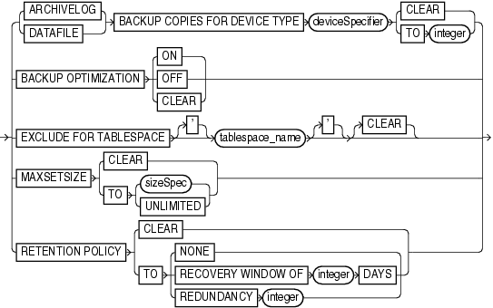

backupConf
This subclause manages persistent configurations relating to the BACKUP command. One configuration is backup optimization. If you enable backup optimization, then RMAN does not back up a file to a device type if the identical file is already backed up on the device type.
Table 2-3 explains the criteria used by backup optimization to determine whether a file is identical and can potentially be skipped. The table also explains the algorithm that RMAN uses when backup optimization is enabled and it needs to determine whether to skip the backup of an identical file. If RMAN does not skip a backup, then it makes the backup exactly as specified.
Table 2-3 Backup Optimization Algorithm
File Type Criteria for an Identical File Backup Algorithm When Backup Optimization Is Enabled
Datafile
The data file must have the same DBID, checkpoint SCN, creation SCN, and RESETLOGS SCN and time as a data file already in a backup. The data file must be offline-normal, read-only, or closed normally.
If a recovery window-based retention policy is enabled, then whether RMAN skips a data file depends on the backup media.
For backups to tape, if the most recent backup is older than the recovery window, then RMAN takes another backup of a data file even if a backup of an identical data file exists. In this way, tapes can be recycled after they expire.
For backups to disk, RMAN skips the backup if an identical data file is available on disk, even if that backup is older than the beginning of the recovery window. The window-based retention policy causes RMAN to retain the old backup for as long as it is needed.
If a retention policy is enabled with CONFIGURE RETENTION POLICY TO REDUNDANCY r, then RMAN skips backups only if at least n backups of an identical file exist on the specified device, where n=r+1.
If no retention policy is enabled, then RMAN skips a backup only if at least n backups of an identical file exist on the specified device. RMAN searches for values of n in this order of precedence (that is, values higher on the list override values lower on the list):
  1. BACKUP ... COPIES n
  2. SET BACKUP COPIES n
  3. CONFIGURE DATAFILE BACKUP COPIES FOR DEVICE TYPE ... TO n
  4. n=1
{ARCHIVELOG | DATAFILE}
deviceSpecifier TO integer
Specifies the number of copies of each backup set for DATAFILE (both data files and control files) or ARCHIVELOG files on the specified device type (see Example 2-42). You can create from 1 (default) to 4 copies.
RMAN can duplex backups to either disk or tape, but cannot duplex backups to tape and disk simultaneously. When backing up to tape, ensure that the number of copies does not exceed the number of available tape devices. Also, if COPIES is greater than 1, then the BACKUP_TAPE_IO_SLAVES initialization parameter must be enabled on the target database.
Control file autobackups are never duplexed. Also, duplexing is not permitted in the fast recovery area.
If duplexing is specified in the BACKUP command or in a SET BACKUP COPIES command, then the CONFIGURE setting is overridden.
BACKUP OPTIMIZATION
[ON | OFF | CLEAR]
Toggles backup optimization ON or OFF (default). Specify CLEAR to return optimization to its default value of OFF.
Backup optimization is enabled when all of the following conditions are met:
  • The CONFIGURE BACKUP OPTIMIZATION ON command has been run.
  • You run BACKUP DATABASE, BACKUP ARCHIVELOG with the ALL or LIKE options, BACKUP BACKUPSET ALL, BACKUP RECOVERY AREA, BACKUP RECOVERY FILES, or BACKUP DATAFILECOPY.
  • The RMAN job uses a channel of only one device type.
Optimization prevents RMAN from backing up a file to a device type if the identical file is already backed up on the device type. RMAN does not signal an error if backup optimization causes all files to be skipped during a backup. The backup retention policy affects which files backup optimization skips.
For two files to be identical, their content must be exactly the same, as described in Table 2-3. When you create backup pieces on disk or on media managed by Oracle Secure Backup, optimization excludes undo data from the backup when the data does not belong to an active transaction.
Note: BACKUP ... DELETE INPUT deletes all specified archived redo logs whether or not optimization skips these files during a backup.
Note: You can override backup optimization with the FORCE option of the BACKUP command.
See Also: Oracle Database Backup and Recovery User's Guide for a description of how RMAN determines that it can skip the backup of a file
EXCLUDE FOR TABLESPACE
tablespace_name [CLEAR]
Excludes the specified tablespace from BACKUP DATABASE and RESTORE DATABASE commands (see Example 2-44). You cannot exclude the SYSTEM tablespace.
The BACKUP command default does not exclude tablespaces. You must declare the option to use it. The exclusion is stored as an attribute of the tablespace and not to the individual data files. In this manner, the exclusion applies not only to the present set of data files but also to any files that are added to this tablespace in the future. If you run CONFIGURE ... CLEAR on a tablespace after excluding it, then it returns to the default configuration of nonexclusion.
You can still back up an excluded tablespace by explicitly specifying it in a BACKUP command or by specifying the NOEXCLUDE option on a BACKUP DATABASE command. Similarly, you can restore an excluded tablespace by specifying it in the RESTORE TABLESPACE command.
MAXSETSIZE Specifies the maximum size of each backup set created on a channel. Use the CLEAR option to return MAXSETSIZE to the default value of UNLIMITED.
Note: This option is ignored by BACKUP AS COPY.
   TO sizeSpec Specifies the maximum size of each backup set as integer gigabytes, kilobytes, or megabytes.
   TO UNLIMITED Specifies no size limit for backup sets.
RETENTION POLICY Specifies a persistent, ongoing policy for backup sets and copies that RMAN marks as obsolete, that is, not needed and eligible for deletion.
As time passes, RMAN marks backup sets and copies as obsolete according to the criteria specified in the retention policy. RMAN automatically deletes obsolete backup sets and copies in the fast recovery area when space is needed. RMAN does not automatically delete obsolete files outside the fast recovery area: you must manually execute DELETE OBSOLETE to remove them.
For backups, the basic unit of the retention policy is a backup set (not a backup piece) or image copy. For example, BACKUP AS BACKUPSET COPIES 4 TABLESPACE users creates a single backup set that is duplexed into four identical backup pieces. The retention policy considers this as one backup, not four separate backups.
Note: Use the CLEAR option to return RETENTION POLICY to its default of REDUNDANCY 1.
   TO NONE Disables the retention policy feature. RMAN does not consider any backup sets or copies as obsolete.
   TO RECOVERY WINDOW
   OF integer DAYS
Specifies a time window in which RMAN can recover the database.
The window stretches from the current time (SYSDATE) to the point of recoverability, which is the earliest date to which you want to recover. The point of recoverability is SYSDATE - integer days earlier.
Note: The REDUNDANCY and RECOVERY WINDOW options are mutually exclusive. Only one type of retention policy can be in effect at any time.
   TO REDUNDANCY integer Specifies that RMAN should retain integer full or level 0 backups of each data file and control file. The default retention policy setting is REDUNDANCY 1.
If more than integer full or level 0 backups of a data file or control file exist, then RMAN marks these extra files as obsolete. RMAN then determines the oldest of the retained backups and marks all archived redo log files and log backups older than this backup as obsolete. The DELETE OBSOLETE command removes obsolete data file backups (full or incremental), control file backups, and archived log backups or image copies.
The following scenario illustrates how redundancy works in an incremental backup strategy. Assume that the redundancy level is 1. You run a level 0 database backup at noon Monday, a level 1 cumulative backup at noon on Tuesday and Wednesday, and a level 0 backup at noon on Thursday. Immediately after each daily backup you run a DELETE OBSOLETE. The Wednesday DELETE command does not remove the Tuesday level 1 backup because this backup is not redundant: the Tuesday level 1 backup could be used to recover the Monday level 0 backup to a time between noon on Tuesday and noon on Wednesday. However, the DELETE command on Thursday removes the previous level 0 and level 1 backups.
