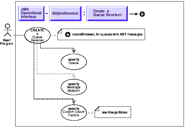

Create a queue receiver for queues of oracle object type (ADT) messages.
The CustomDatum factory for a particular java class that maps to the SQL ADT payload can be obtained via the getFactory static method.
Assume the Queue - test_queue has payload of type SCOTT.EMPLOYEE and the java class that is generated by Jpublisher for this ADT is called Employee. The Employee class implements the CustomDatum interface. The CustomDatumFactory for this class can be obtained by using the Employee.getFactory() method.
/* Create a receiver for a Queue with Adt messages of type EMPLOYEE*/ QueueSession jms_session QueueReceiver receiver; Queue test_queue; browser = ((AQjmsSession)jms_session).createReceiver(test_queue, "JMSCorrelationID = 'MANAGER', Employee.getFactory());
