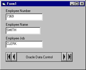

4. When the Oracle Data Control is set up, you can access the data in a Visual Basic control, such as a TextBox control, that you drag and drop on a form. Simply set the Data properties to access the data field and source that you want.
5. When the project is run, the data identified by the RecordSource property is displayed and can be navigated with the Oracle Data Control.

4. You can access the data in the RecordSource using Visual Basic controls, such as a TextBox. For example, after you insert a TextBox on the form, you can set the DataSource property to ORADataControl and the DataField property to EMPNO. When the project is run, the DataSource and DataField properties will point to the data objects that you have specified.
