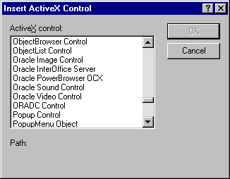

  12. With the dialog selected, press the right mouse button to display the pop-up menu. Select Insert ActiveX control from the menu. Select Oracle Data Control in the window and then select OK.

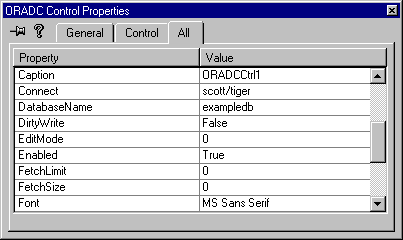

  15. Display the All tab of the Properties window and set the following:
· Connect: scott/tiger
· Database: exampledb
· RecordSource: select * from emp
16. With the dialog selected, press the right mouse button to display the pop-up menu. Select Insert ActiveX control from the menu. Locate the DB Grid Control and select OK.

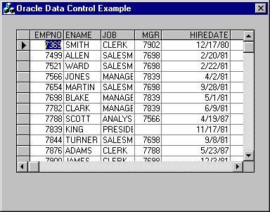

19. Build and Execute the project.
20. The DB Grid displays the records from the
emp table as in the following illustration.
