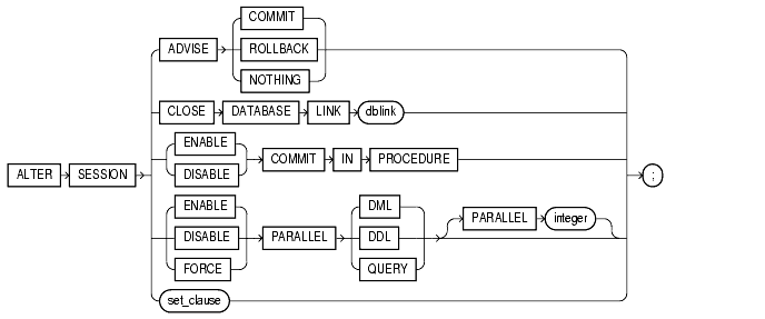

Oracle8i SQL Reference Release 2 (8.1.6) A76989-01 |
SQL Statements (continued), 2 of 5
To specify or modify any of the conditions or parameters that affect your connection to the database. The statement stays in effect until you disconnect from the database.
To enable and disable the SQL trace facility, you must have ALTER
SESSION
system privilege.
You do not need any privileges to perform the other operations of this statement unless otherwise indicated.
sends advice to a remote database to force a distributed transaction. The advice appears in the
You can send different advice to different remote databases by issuing multiple |
closes the database link dblink. When you issue a statement that uses a database link, Oracle creates a session for you on the remote database using that link. The connection remains open until you end your local session or until the number of database links for your session exceeds the value of the initialization parameter |
Procedures and stored functions written in PL/SQL can issue
You can subsequently allow procedures and stored functions to issue
Some applications (such as SQL*Forms) automatically prohibit |
Note: This statement does not apply to database triggers. Triggers can never issue |
specifies whether all subsequent DML, DDL, or query statements in the session will be considered for parallel execution. This clause enables you to override the degree of parallelism of tables during the current session without changing the tables themselves. You can execute this clause for DML only between committed transactions. Uncommitted transactions must either be committed or rolled back prior to executing this clause for DML. |
executes subsequent statements in the session in parallel. This is the default for DDL and query statements. |
Restriction: You cannot specify the optional |
specifies that subsequent statements will be executed serially. This is the default for DML statements. |
forces parallel execution of subsequent statements in the session. If no parallel clause or hint is specified, then a default degree of parallelism is used. This clause overrides any parallel_clause specified in subsequent statements in the session, but is overridden by a parallel hint. |
The following types of DML operations are not parallelized regardless of this clause: |
For a detailed description of parallel DML features and hints, see Oracle8i Designing and Tuning for Performance. |
set_clause |
sets the session parameters that follow. You can set values for multiple parameters in the same set_clause. |
CAUTION: Unless otherwise indicated, the parameters described here are initialization parameters, and the descriptions indicate only the general nature of the parameters. Before changing the values of initialization parameters, please refer to their full description in Oracle8i Reference or Oracle8i National Language Support Guide. |
