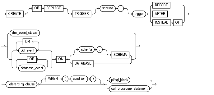

creates a new trigger. When you create a trigger, Oracle enables it automatically. You can subsequently disable and enable a trigger with the |
If a trigger produces compilation errors, it is still created, but it fails on execution. You can see the associated compiler error messages with the SQL*Plus command |
re-creates the trigger if it already exists. Use this clause to change the definition of an existing trigger without first dropping it. |
schema |
is the schema to contain the trigger. If you omit schema, Oracle creates the trigger in your own schema. |
trigger |
is the name of the trigger to be created. |

causes Oracle to fire the trigger before executing the triggering event. For row triggers, this is a separate firing before each affected row is changed. Restrictions: |
causes Oracle to fire the trigger after executing the triggering event. For row triggers, this is a separate firing after each affected row is changed. Restrictions: |
Note: When you create a materialized view log for a table, Oracle implicitly creates an See Also: "CREATE MATERIALIZED VIEW LOG / SNAPSHOT LOG" for more information on materialized view logs. |
causes Oracle to fire the trigger instead of executing the triggering event. By default,

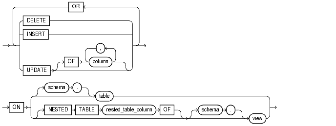

dml_event_clause |
specifies one of three DML statements that can cause the trigger to fire. Oracle fires the trigger in the existing user transaction. |
causes Oracle to fire the trigger whenever a |
causes Oracle to fire the trigger whenever an |
For an |
Note: Using OCI functions or the |
Restrictions:
Performing DML operations directly on nested table columns does not cause Oracle to fire triggers defined on the table containing the nested table column |

determines the database object on which the trigger is to be created. |
[schema.] table | view |
specifies the schema and table or view name of one of the following on which the trigger is to be created: |
If you omit schema, Oracle assumes the table is in your own schema. You can create triggers on index-organized tables. Restriction: You cannot create a trigger on a table in the schema SYS. |
specifies that the trigger is being defined on column nested_table_column of a view. Such a trigger will fire only if the DML operates on the elements of the nested table.
Restriction: You can specify |

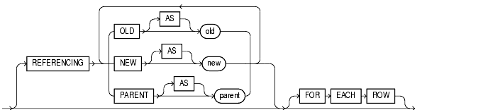

referencing_clause |
specifies correlation names. You can use correlation names in the PL/SQL block and |
Restriction: This clause is valid only for DML event triggers (not DDL or database event triggers). |
designates the trigger to be a row trigger. Oracle fires a row trigger once for each row that is affected by the triggering statement and meets the optional trigger constraint defined in the WHEN condition. Note: This clause is applies only to DML events, not to DDL or database events. |
