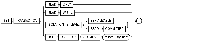

Syntax

Keywords and Parameters
READ ONLY
establishes the current transaction as a read-only transaction. This clause established transaction-level read consistency.
See Also: Oracle8i Concepts.
All subsequent queries in that transaction only see changes committed before the transaction began. Read-only transactions are useful for reports that run multiple queries against one or more tables while other users update these same tables.
Restriction: Only the following statements are permitted in a read-only transaction:
  • subqueries (that is, SELECT statements without the for_update_clause)
  • LOCK TABLE
  • SET ROLE
  • ALTER SESSION
  • ALTER SYSTEM
READ WRITE
establishes the current transaction as a read-write transaction. This clause established statement-level read consistency, which is the default.
Restriction: You cannot toggle between transaction-level and statement-level read consistency in the same transaction.
ISOLATION LEVEL
specifies how transactions containing database modifications are handled.
SERIALIZABLE
specifies serializable transaction isolation mode as defined in SQL92. If a serializable transaction contains data manipulation language (DML) that attempts to update any resource that may have been updated in a transaction uncommitted at the start of the serializable transaction, then the DML statement fails.
Note: The COMPATIBLE initialization parameter must be set to 7.3.0 or higher for SERIALIZABLE mode to work.
READ COMMITTED
is the default Oracle transaction behavior. If the transaction contains DML that requires row locks held by another transaction, then the DML statement waits until the row locks are released.
USE ROLLBACK SEGMENT
assigns the current transaction to the specified rollback segment. This clause also implicitly establishes the transaction as a read-write transaction.
This clause lets you to assign transactions of different types to rollback segments of different sizes. For example:
  • If no long-running queries are concurrently reading the same tables, you can assign small transactions to small rollback segments, which are more likely to remain in memory.
  • You can assign transactions that modify tables that are concurrently being read by long-running queries to large rollback segments, so that the rollback information needed for the read-consistent queries is not overwritten.
  • You can assign transactions that insert, update, or delete large amounts of data to rollback segments large enough to hold the rollback information for the transaction.
You cannot use the READ ONLY clause and the USE ROLLBACK SEGMENT clause in a single SET TRANSACTION statement or in different statements in the same transaction. Read-only transactions do not generate rollback information and therefore are not assigned rollback segments.
