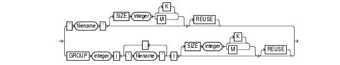

logfile logSpec |
specifies the online redo logs. The syntax is the same used in the LOGFILE option of the CREATE DATABASE statement. If you do not specify the logfile clause, then RMAN uses LOG_FILE_NAME_CONVERT if it is set. If neither logfile nor LOG_FILE_NAME_CONVERT is specified, RMAN uses the original target redo log filenames for the duplicate files. You must use the nofilenamecheck option in this case. See Also: Oracle8i SQL Reference for more about the CREATE DATABASE statement. |
'filename' |
specifies the filename of the online redo log. |
size integer |
specifies the size of the file in kilobytes (K) or megabytes (M). If you omit this parameter, the file must already exist. |
reuse |
allows Oracle to reuse an existing file. If the file already exists, Oracle verifies that its size matches the value of the size parameter. If the file does not exist, Oracle creates it. If you omit the size parameter, the file must already exist. The reuse option is significant only when used in conjunction with the size parameter. If you omit the size parameter, Oracle expects the file to exist already. |
group integer ('filename', ... ) |
specifies a redo log group containing one or more members. Each filename specified within the parentheses indicates a member of the group. |
