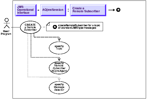

Create a remote subscriber for topics of jms messages without selector.
AQ allows topics to have remote subscribers, i.e. subscribers at other topics in the same or different database. In order to use remote subscribers, you must set up propagation between the local and remote topic.
Remote subscribers may be a specific consumer at the remote topic or all subscribers at the remote topic. A remote subscriber is defined using the AQjmsAgent structure. An AQjmsAgent consists of a name and address. The name refers to the consumer_name at the remote topic. The address refers to the remote topic - the syntax is (schema).(topic_name)[@dblink].
a) To publish messages to a particular consumer at the remote topic, the subscription_name of the recipient at the remote topic must be specified in the name field of AQjmsAgent. The remote topic must be specified in the address field of AQjmsAgent
b) To publish messages to all subscribers of the remote topic, the name field of AQjmsAgent must be set to null. The remote topic must be specified in the address field of AQjmsAgent
A message selector can also be specified. Only messages that satisfy the selector are delivered to the remote subscriber. The message selector can be null. The syntax for the selector is the same as that for createDurableSubscriber. The selector can be null.
TopicConnectionFactory tc_fact = null; TopicConnection t_conn = null; TopicSession t_sess = null; TopicSession jms_sess; TopicSubscriber subscriber1; Topic shipped_orders; int my[port = 5521; AQjmsAgent remoteAgent; /* create connection and session */ tc_fact = AQjmsFactory.getTopicConnectionFactory("MYHOSTNAME", "MYSID", myport, "oci8"); t_conn = tc_fact.createTopicConnection("jmstopic", "jmstopic"); jms_sess = t_conn.createTopicSession(true, Session.CLIENT_ACKNOWLEDGE); shipped_orders = ((AQjmsSession )jms_sess).getTopic("OE", "Shipped_Orders_ Topic"); remoteAgent = new AQjmsAgent("WesternRegion", "WS.shipped_orders_topic", null); /* create a remote subscriber (selector is null )*/ subscriber1 = ((AQjmsSession)jms_sess).createRemoteSubscriber(shipped_orders, remoteAgent, null);
