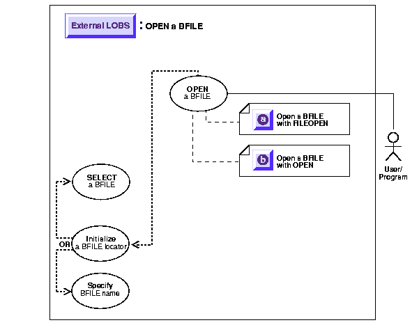

"Use Case Model: External LOBs (BFILEs)" for all basic operations of External LOBs (BFILES). |
As you can see by comparing the code, these alternative methods are very similar. However, while you can continue to use the older FILEOPEN form, we strongly recommend that you switch to using OPEN because this facilitates future extensibility.
