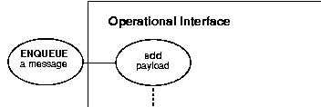

In this example, specify message properties, specify options, and add payload are all expanded in separate use case diagrams.
This diagram fragment shows the use case diagram expanded. While the standard diagram has the actor as the initiator), here the use case itself is the point of departure for the sub-operation.
In this example, the expanded view of add payload represents a constituent operation of ENQUEUE a message.

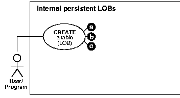

This convention (a, b, c) shows that there are three different ways of creating a table that contains LOBs.
This fragment shows use of a NOTE box, here distinguishing which of the three ways of creating a table containing LOBs.

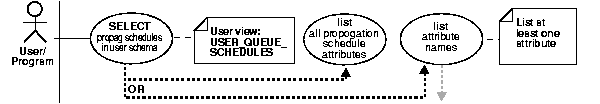

This drawing shows two other common sees of NOTE boxes:
(a) A way of presenting an alternative name, as in this case the action SELECT propagation schedules in the user schema is represented by the view USER_QUEUE_SCHEDULES
(b) The action list attribute names is qualified by the note to the user that you must list at least one attribute if you elect not to list all the propagation schedule attributes.

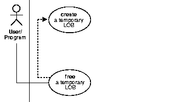

The dotted arrow in the use case diagram indicates dependency. In this example, free a temporary LOB requires that you first create a temporary LOB.
This means that you should not execute the free operation on a LOB that is not temporary.
What you need to remember is that the target of the arrow shows the operation that must be performed first.

In this case, the branching paths of an OR condition are shown. In invoking the view, you may either choose to list all the attributes or to view one or more attributes. The fact that you can stipulate which of the attributes you want made visible is indicated by the grayed arrow.

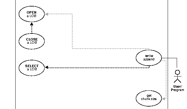

Not all lined operations are mandatory. While the black dashed-line and arrow indicate that you must perform the targeted operation to complete the use case, actions that are optional are shown by the grey dashed-line and arrow.
In this example, executing WRITEAPPEND on a LOB requires that you first SELECT a LOB.
As a facilitating operations, you may choose to OPEN a LOB and/or GETCHUNKSIZE.
However, note that if you OPEN a LOB, you will later have to CLOSE it.
