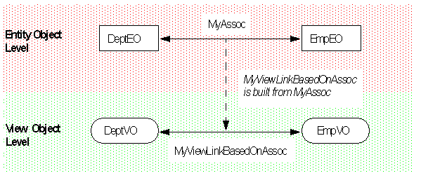

Use the createViewLinkFromEntityAssocName method to create a View Link when your code can access the View Objects and an Entity Association. This method can create a View Link because a View Link Definition can be built from the Entity Association between the underlying Entity Objects.
For example, during design time you can define View Objects such as DeptVO for the DeptEO Entity Object, and EmpVO for the EmpEO Entity Object. Then you can define an Association named MyAssoc that associates DeptEO to EmpEO. With this information, you can build a View Link Definition, say MyViewLinkBasedOnAssoc, which relates DeptVO to EmpVO, based on this Entity Association. This relationship is illustrated below:
