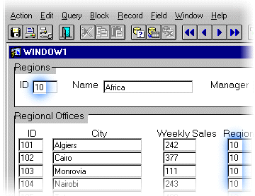

The last task is to remove the REGION_ID item of the OFFICE block from the layout. Since REGION_ID is a foreign-key column that joins the OFFICE and REGION tables (recall the join condition that Form Builder auto-created earlier), there is no need to display the same information twice.
To remove OFFICE.REGION_ID from the layout, you will re-enter the Layout Wizard.
