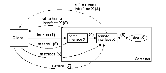

An Enterprise JavaBean has two client interfaces: a remote interface and a home interface. The remote interface specifies the methods that the object's clients can invoke; the home interface defines how clients can create the object, which returns a reference to the object. The client uses both of these interfaces when invoking a method on a bean.
The events that occur when a client invokes a method within a bean are explained in the following diagram and steps:
Figure 2-1 Sequence of events in a session bean lifecycle
The numbers in the figure correspond to the following numbered steps:
  1. Client 1 looks up home interface of bean X.
    During the JNDI lookup, the database creates a session for the server-side of the request.
  2. Reference to home interface X is returned to client 1.
  3. Client 1 invokes create on home interface X.
    The bean instance is created within the session that was established on the JNDI lookup.
  4. Home interface X instantiates remote interface X. The container instantiates the bean for this client and is destroyed only when the client invokes the remove.
    The object reference of remote interface X is returned to client 1.
  5. Client 1 uses remote interface X to invoke methods on bean instance X.
  6. Remote interface X delegates call to a bean.
  7. Client 1 invokes remove on remote interface X when it is done with the bean instance. This destroys the remote interface and the bean instance.
