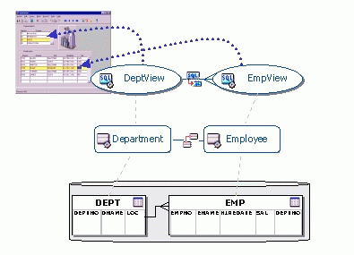

An example of a relationship is a one-to-many association between departments and employees. They might have a relationship where the Dept entity object has a Deptno attribute that is related to the Deptno attribute of the Emp entity object (Dept.Deptno = Emp.Deptno), as shown in the following figure. The DEPT and EMP tables are at the bottom of the figure, and the Dept and Emp entity objects are at the top of the figure. They have a master-detail relationship.
The following figure shows how the association, named FkDeptnoAssoc, would appear in the JDeveloper Structure pane:
The source end is the Dept entity object (the master) and the destination end is the Emp entity object (the detail).
