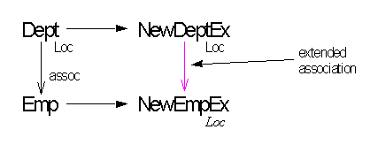

Figure 1: Substituting an Extended Association
As Figure 1 illustrates, assume that when you extended the Emp Entity, you added a Loc (location) attribute. Then when you create the extended association between NewEmpEx and NewDeptEx you can add Loc to the lists of source and destination role attributes. If you then substitute the extended association into the application, you must also substitute NewEmpEx (because Emp does not have a Loc attribute) and NewDeptEx (because Dept does not recognize Loc as a source role attribute).
