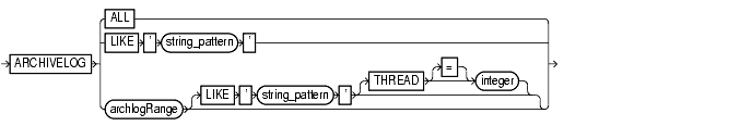

archlogRange::=
A subclause used to specify an archived log or range of archived redo logs files for use in backup, restore, recovery, and maintenance operations.
When backing up archived redo logs, RMAN can perform archived log failover automatically. RMAN backs up the log when at least one archived log corresponding to a given log sequence number and thread is available. Also, if the copy that RMAN is backing up contains corrupt blocks, then it searches for good copies of these blocks in other copies of the same archived logs.
Specifying a range of archived redo logs does not guarantee that RMAN includes all redo data in the range: for example, the last available archived log file may end before the end of the range, or an archived log file in the range may be missing from all archiving destinations. RMAN includes the archived redo logs it finds and does not issue a warning for missing files.

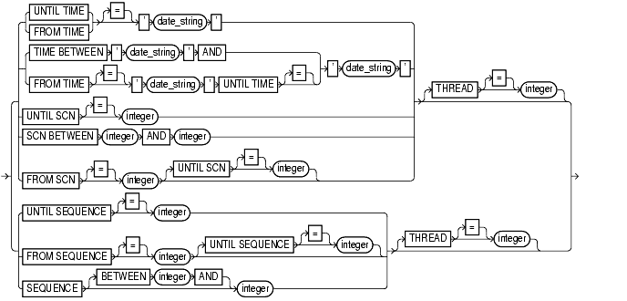

Specifies the end date for a sequence of archived redo log files. The clause specifies those logs that could be used to recover to the indicated time. The time specified in the string must be formatted according to the Globalization Technology date format specification currently in effect, but can also be any SQL expression with the If you do not specify the Note: The See Also: Oracle9i Database Reference for information on how to use the |
Specifies the beginning date for a sequence of archived redo log files. The clause specifies those logs that could be used in a recovery starting at the indicated time. The time specified in the string must be formatted according to the Globalization Technology date format specification currently in effect, but can also be any SQL expression with the If you do not specify the Note: The See Also: Oracle9i Database Reference for information on how to use the |
Specifies a range of times. Note that |
Specifies the ending SCN for a sequence of archived redo log files. If you do not specify the |
Specifies a range of SCNs. |
Specifies the beginning SCN for a sequence of archived redo log files. If you do not specify the |
Specifies the terminating log sequence number for a sequence of archived redo log files. If you do not specify the |
Specifies the beginning log sequence number for a sequence of archived redo log files. If you do not specify the Note: You can specify all log sequence numbers in a thread by using the following syntax, where
... ARCHIVELOG FROM SEQUENCE 0 THREAD
Specifies either a single log sequence number or a range of sequence numbers. |
Specifies a single log sequence number. |
Specifies a range of log sequence numbers. |
Specifies the thread containing the archived redo log files you wish to include. You only need to specify this parameter when running the database in an Oracle Real Application Clusters configuration.
